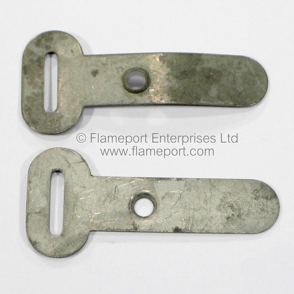

Hi, I know that whoever takes the job on is going to have a hard time pulling the cables out of the back of old fusebox as some monkey back in 78 "stapled" twin and earths to plasterboard woodwork, as seen with snakescope! In view of what you said I shall just free up the cables thru light switch back box opposite, never seen such meaty staples!
we used to use a section of twin and earth as a clip and nail it in, either that or those old thin metal P clips, whack a nail in then fold its over the cable and through the buckle
young people today, they dont know they're born!!

Those are stick on, but with the cable collapse under fire concerns are they not making the metal style again for T&E fixing?
they are stick on, but you can nail them. i'd not rely on stick on anyway, fire or no fire.
stuck some in the van for the LED strip lighting. they fell off within a week.
