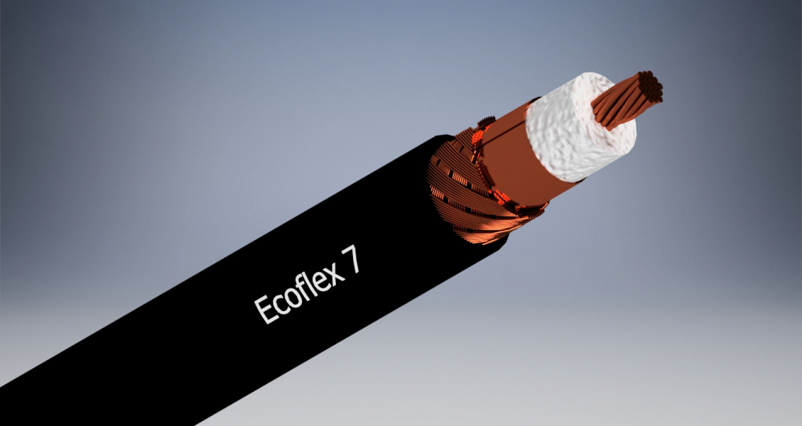

On first reading this I was puzzled, seems there is more than one Ecoflex to the one I know of:
