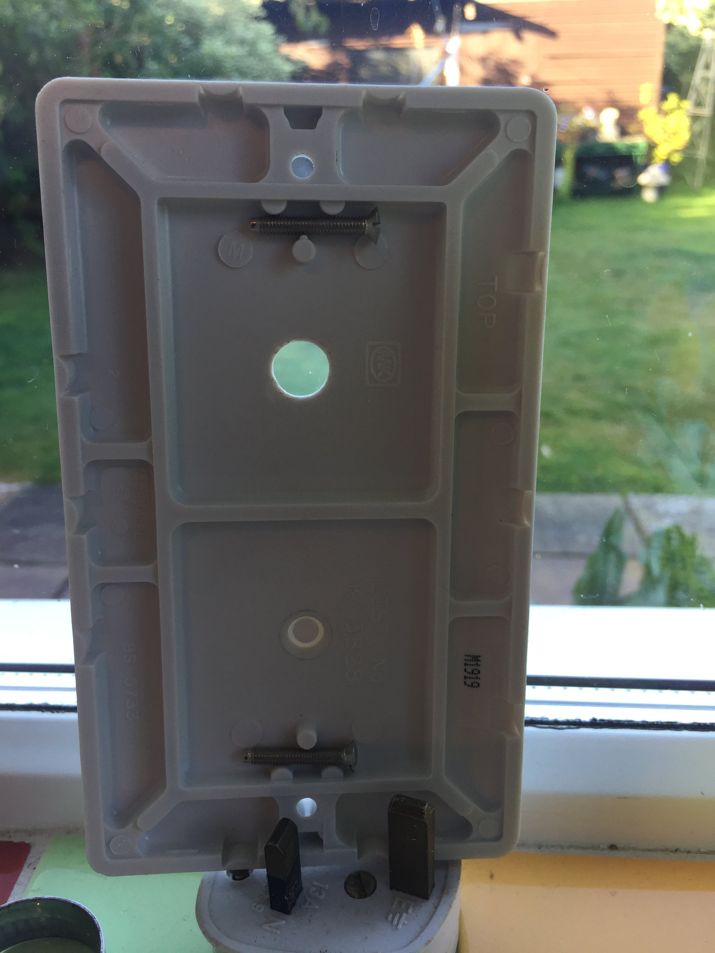

or better still put a planking plate on and come out off the back box by extending the cable .

Yes, could do but am somewhat surprised that there isn't a purpose built product especially as this must be quite a common scenario. Perhaps Im over complicating things!
I agree, which is why I suggested a maintenance free joint since the blanking plate may not be easily accessible.
Just trying to get a neat way of routing the cable through the blanking plate which ideally would need some sort of clamp to protect it from being pulled and stressing the actual conductor connectors.

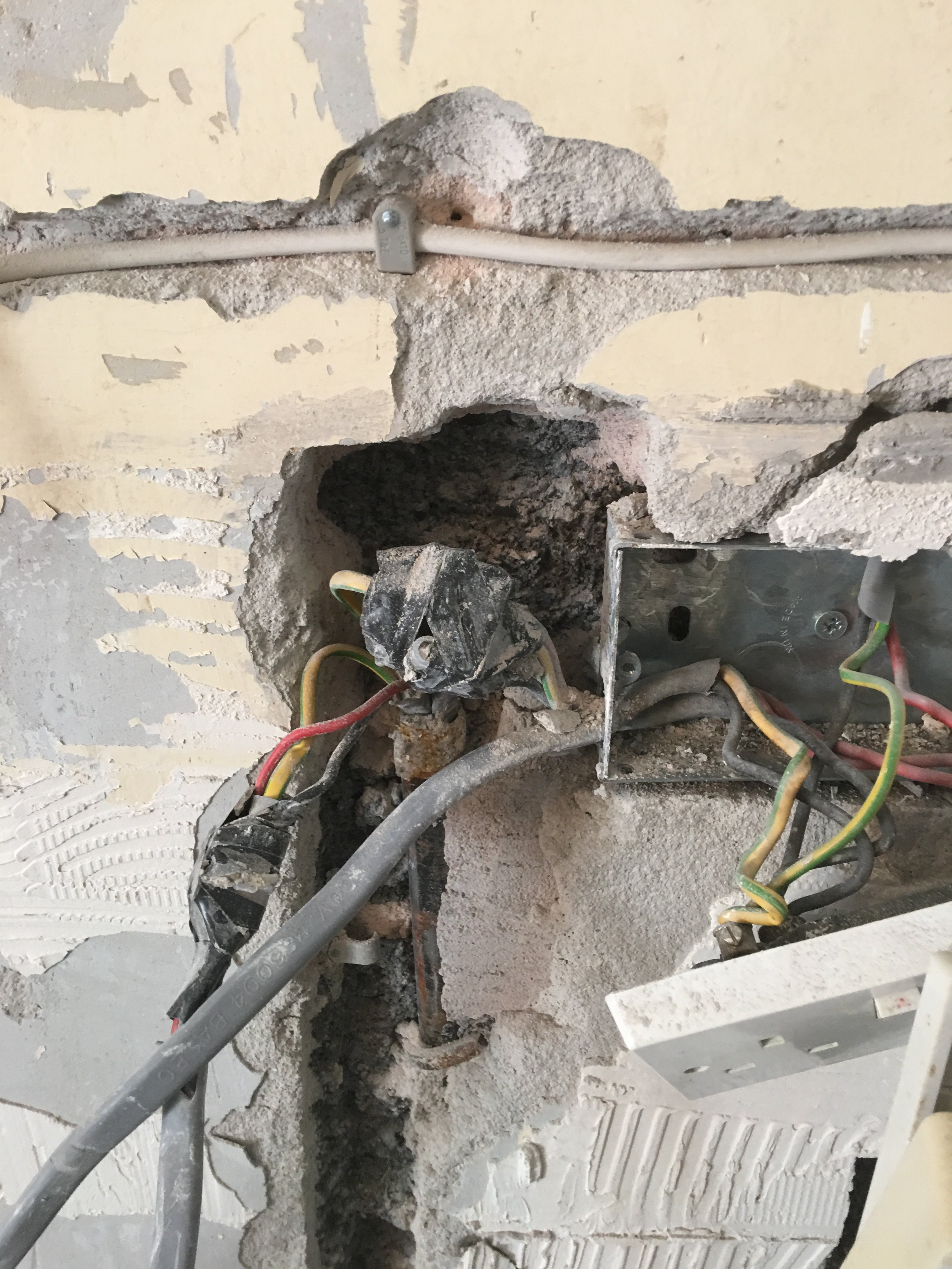

Thanks for the responses folks. Just makes you wonder how many non MF sockets and connection units are hidden and inaccessible behind fitted kitchen units :eek:
Thousands and possibly millions...
Rip out a kitchen that was fitted in the 1980s or 1990s and I would bet my bottom dollar you will find at least one totally hidden jointed cable
