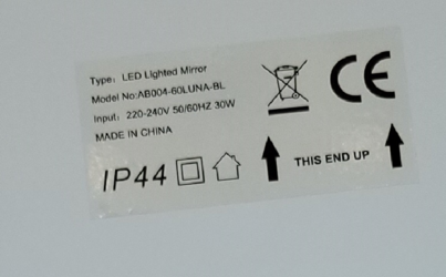

I recently bought a bathroom mirror with LED & Bluetooth speakers (from Amazon). There is a double isolated symbol on the back of the mirror yet there is also an earth wire connection. Is this unusual and should it be a cause of concern? It has not been installed yet - just wondering what your thoughts are in regard to the safety of this product.

No it shouldn't have an earth but without it then it is debatable whether it is double insulated. Does the earth actually connect to the metalwork?
If it were me I would send it back and get something from a reputable vendor, not Amazon.
It does not meet requirements for a double insulated product, but is marked with the class II symbol.
Too much stuff like this on the market now unfortunately.
