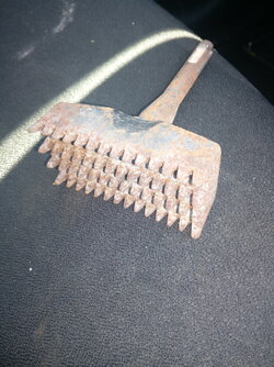

Does any one know the name of this sds chisel in the photo I've had it a while but cannot find another or what it's called, it's great for doing neat back box cuts in brickIMG_20190917_090213.jpg

Armeg do a channelling bit,swear there was a thread asking to identify the tool, thought it was this one.
https://www.NoLinkingToThis/p/armeg...nbjw89siuFXtlGWtINhqPc_uTK2jpzCsaAi0pEALw_wcB
these are brilliant. takes the hard work out of sinking boxes.
( n.b. not suitalle for small children or dry lining):
https://www.NoLinkingToThis/p/dewalt-sds-plus-shank-comb-chisel-32-x-200mm/4326v
They're brilliant, all the bricklayers used them as their weapon of choice for demolition, chopping out old brickwork, cutting in doorways etc etc.
If I remember correctly they called them rex (or possibly wrecks) tools.
They kept them closely guarded but I managed to get hold of one for chasing.
