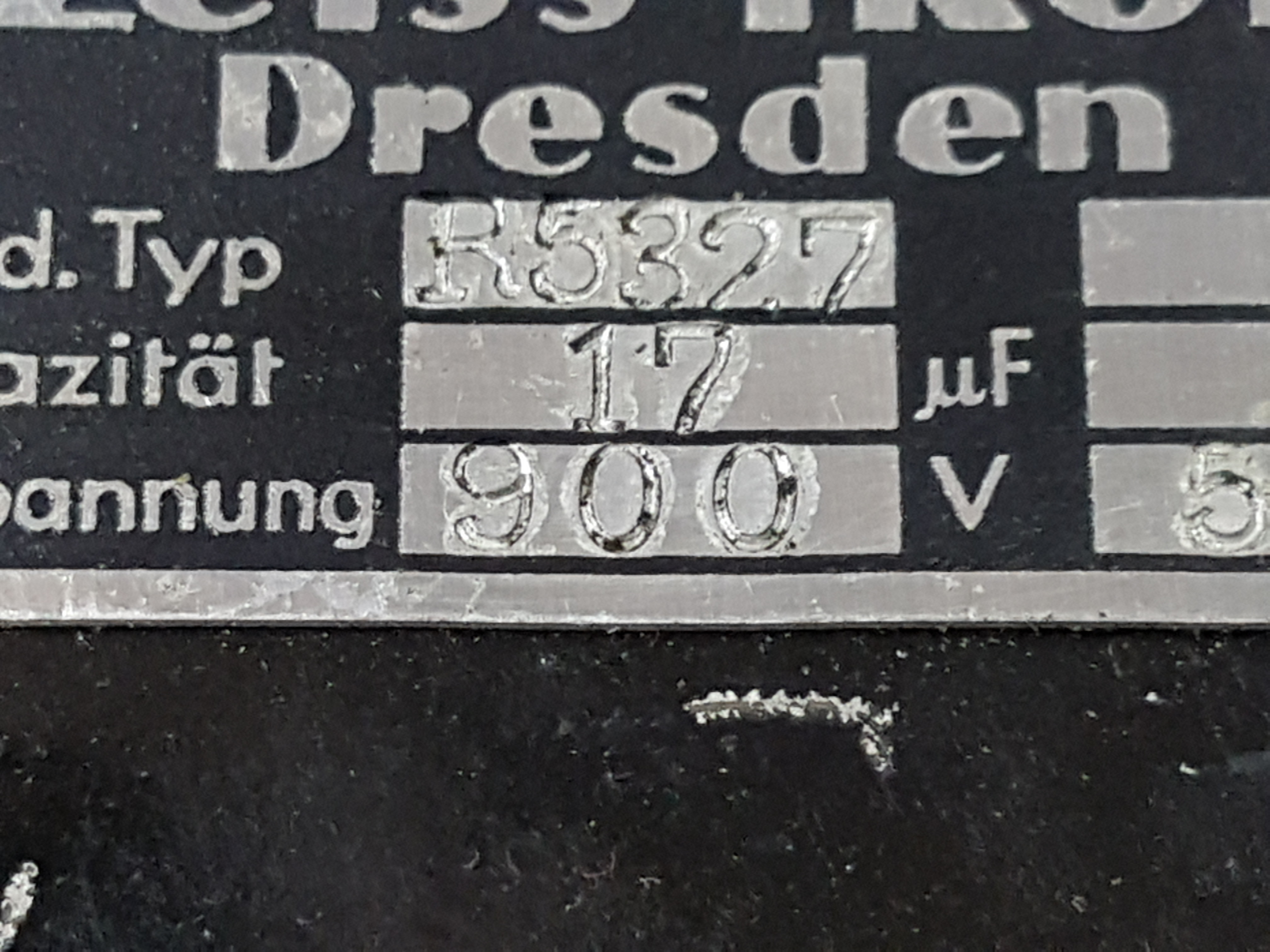

We've had a few threads about phase converters recently. Here's one I repaired on Monday. It's a little box that takes in single-phase 230V and feeds a 3-phase motor wired for 230V delta. It includes a manual 'soft' starter and overload relay. Unlike the units in the other threads, this one dates from around WW2. More pics and video tomorrow!
The starter was working, but the back of the box was warm to the touch when running, which it shouldn't be. The heat was coming from the large black box bottom left, which contains a 17µF paper-in-oil capacitor of 900V AC test voltage. Failed leadout seals have let in moisture, giving 20kΩ of leakage resistance (in capacitors, leakage doesn't mean earth leakage, just a resistance in parallel with the capacitance) which would soon have cooked it and perhaps caused a solid short. FWIW paper capacitors also develop leakage without being unsealed - the paper can degrade and release moisture and contaminants into the impregnation.
This was a field repair so I took along two 35µF 470V caps to connect in series, and as a precaution, a 10µF 450V type to replace the green cap bottom right (although that cap turned out to be in perfect condition electrically, like the two grey ones above). I'll do a permanent job when it gets back to the workshop, but for now, the three capacitors are strapped together and slotted into place with a suitable packing piece.

The starter is operated by steadily raising the handle at the side. This turns a small drum-switch that re-arranges the caps in a sequence that boosts torque at starting. It then latches in the run position with the ideal running cap values connected and the resistance out of circuit. When the manual stop button is pressed or the overload coil operates, the handle springs back to the stop position. There is no zero-volt release; if power is lost and restored with the handle latched in the run position, if the machine is still turning it will regain speed, which is preferable in this application. If it is stationary, it might start, or if not, the overload coil will trip.
The motor runs silently with reassuring voltage symmetry. After the repair it had something like 232, 236 and 237V on the three phases. It looks like any normal 3-phase induction motor but it is actually synchronous and runs at exactly 1500 rpm without slip, and would drive a clock with perfect accuracy. The rotor has a cage winding for starting, but also salient poles so that when it approaches synchronous speed, it pulls into step with the stator flux wave and runs as a reluctance motor. One limitation of the salient-pole synchronous motor (unlike a hysteresis type) is the definite maximum moment of inertia it can drive, because of the need to accelerate the load fast enough to pull-in within one half-cycle of slip. This motor is well matched to the machine and runs up smoothly in a second or so.
