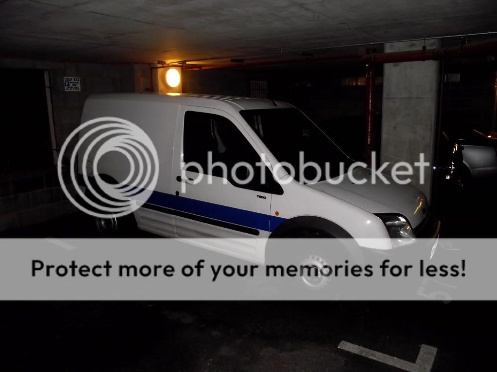

I've had a bit of a result here....
I got a van off a mate who leases to the council ;
2003 Transit Connect, serviced every 10,000 miles, long list of maintenance work including new clutch 2000 miles ago.. City van basically.
It came back pretty mint apart from a little dent in one of the back doors and a MASSIVE BLUE STRIPE DOWN BOTH SIDES. Yes.
These are mostly returned with tow bars, but this one hasn't got one so it's not been under too much strain....
41,168 miles!!!!! Not too shabby for an '03!!
£1600
WELL pleased.
It's a bit of a greenhouse at the moment, no bulkhead and clear glass windows in the back doors, but I reckon that's a council anti-theft thing so people can see that it's empty.
I'm going to put in a full steel bulkhead and get the rear windows caged and tinted but I can't complain for this price.
Then maybe a remap and some pretty wheels.
Ideally I'd like it to be doing the 1/4 mile in under 12 seconds.

I need to do this, there was a post not so long ago about that easy way in.
luverly jubbly @ that price you could buy a few n sell em 2 forum members lol
I'm going to talk to him... I did have a total result with this one (mileage etc), but still a good buy with double that I think.
The councils really look after their fleet mechanically.
