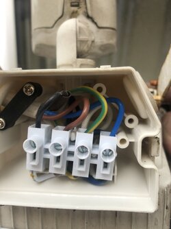

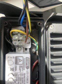

I have just bought two new spotlights and the existing has live, live 1, earth and neutral, but the new lights have live, earth and neutral.
Can the 4 connections go into 3?
Two spotlights, sensor triggered and switch in kitchen (mains connected.)
In the second picture have you put the black in with the blue ?
I have a feeling the black is a live
agree. think the black has a brown sleeve, and appears to connect to 1 side of the load, so will be a SW/L. for manual override.
