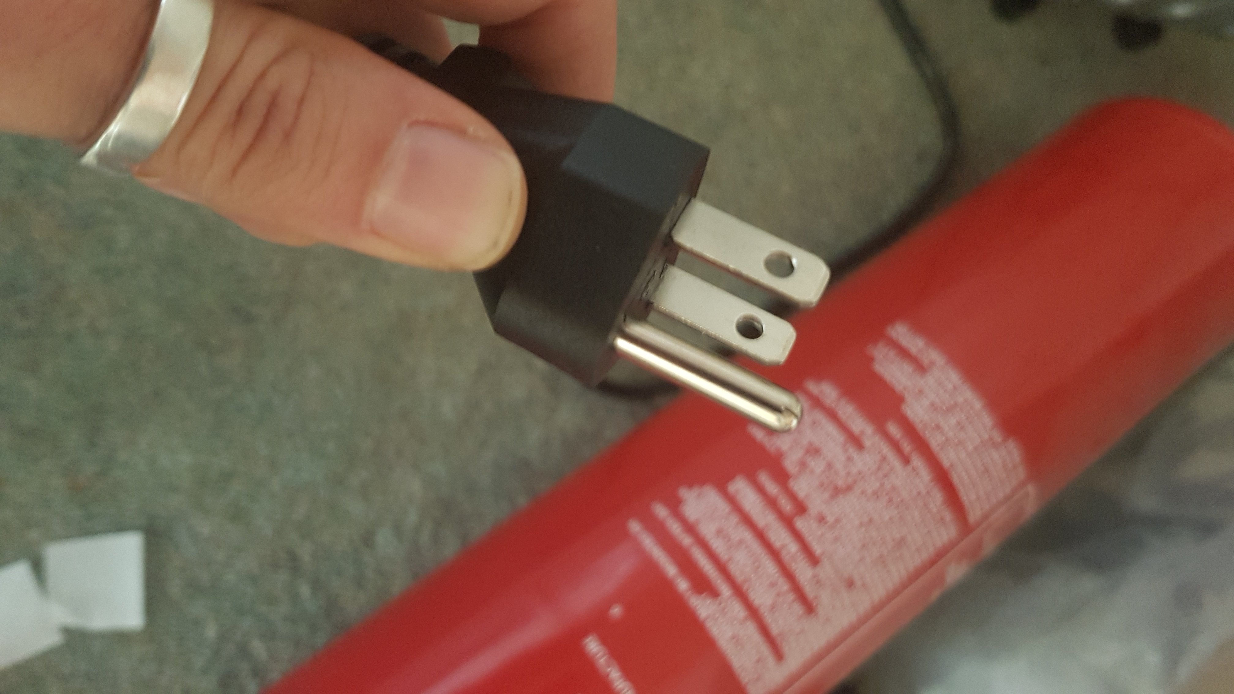

I run a 45W laser from a residential building, this is an import from USA. I have been looking at upgrading the laser, but need to check its grounded properly (as apparently it sends up to 20,000V thru tube when live!).
Because it is a US system, obviously the plug can't go straight in the wall....
It goes through the following system:
Laser plug (w. ground pin) -> US 4-gang socket (w.ground pin)
US 4-gang socket with air pump etc.(w.ground pin) -> 110V to 220V EU transformer (supplied by laser manufacturer)
The plug coming off this transformer then has no ground pin, but it has the grounding contacts seen on EU plugs.
And the adaptor (again supplied by manufacturer) has no ground pin.
I've attached images, hopefully in sequence so you can see.
My very elementary question, if there is no ground pin in the plugs going into the plug socket, is there a problem with my ground connection from the laser?
Explanations to convince me I'm safe (and ridicule!) welcome

As you say the US / UK adaptor has no earth.
The transformer plug has no earth.
Is the transformer part of the Laser package? or is it "compatable" and is just a transformer?
Any part number or coding on the transformer? Look for SELV / PELV perhaps

The need for earthing will depend on the design of the connected equipment and since it had an earthed plug for use in US, it's likely it will need one here too. Perhaps some pics of the things connected to the transformer?

I do not like the look of that white power supply the pins look incorrectly spaced from the edge.
Westward10 - do you mean the adapter with "Europe" written on it? (Final image). As this is the one I'm worried about! The others are US plugs so I have no comparison to what they should look like ...

Personally I would bin the Euro to UK adaptor, cut the Shucko plug off and fit a UK plug.
However the above would only be carried out once the earthing and power requirements of the transformer are known.
Agree with all the adapter concerns. It's something you don't want. I do think the machine looks like it should be earthed for safety. An alternative might be to run the dingus off a balanced 110V site supply - what do you think Brainiacs?
