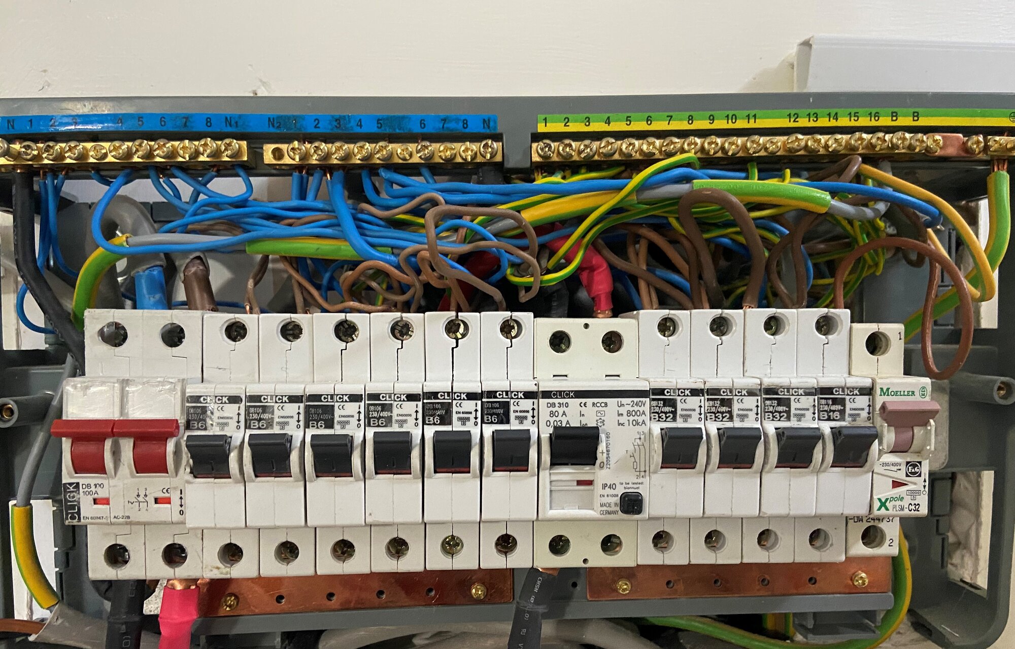

Morning everyone, I have a customer with an old CLICK consumer unit, the MCBs are DB132, DB106, DB116 etc. Does anyone know if the new CLICK elucian range of RCBOs fit this board? I have a picture of the consumer unit (Looks like a bomb has went off) if needed. Appreciate any answers.
Kind regards.
To fit RCBOs you'd have to strip it down anyway as it's such a mess. The breakers are falling apart on the RCD side too.
If the intention is to replace all of the lighting circuit B6 breakers, then it would cost about £80 for the parts.
A brand new loaded dual RCD BG unit is £65. Now I wouldn't ideally fit that these days as it's Type AC RCDs.
But for £115 you could get an Mk Sentry Dual (type A) RCD with SPD (Screwfix special offer!).
Tell the customer that's less than £1 per year over the expected lifetime of the new board.
