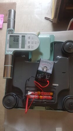

Hi, I have these Omron BF511 scales which notoriously develop a battery drain problem. Normally they are supposed to last a year but suddenly they start draining a set of 4 AA batteries within a day.
I took it apart to see if it has suffered from water damage. And indeed it had. The water itself dries off but there is a metallic ceiling above the board which has dripped a rust water on it and I suspected was the culprit.
After few accidentally ripped and resoldered (with a nail heated on gas ring) wires and rust cleaned off, I am reluctant to test next set of batteries to see if they quickly die.
I just received analog ammeter I ordered on Aliexpress. My idea was to measure the resistance and see if disconnecting some elements would clear it but I am confused now.
It shows -20 with needles disconnected and somewhat around 0 when connected. Does it mean there is no resistance?
I have been solving the problem up until now by putting an insulator in between batteries as on photo.

20211117_101850.jpgWith a nerve to continue this imbecility I tried amperage with the scales on. The needles are located around break in chain so are indeed part of the draw. And the scales go off if ammeter disconnected or switched to voltage. Why is draw nothing? The draw is the same nothing with scales ON and OFF.

Using the meter on amps and ohms is never going to work out , only DC volts should be used to measure battery voltage, current draw would require the meter in series with the batteries

You need to get the meter in SERIES with the batteries to check.

BTW I think the cleaning the board from dried rust water has sorted it out. I forgot the batteries in and they have not drained.

Actually no, it moves the needle clockwise only if i connect black to - and red to +. The resistance maxes out at any setting and the mA shows 50 with the scales off. So assuming the batteries have 1000 mAh, they run out in 20h.

  • the ohmmeter shows 2, 5 and 8 on x1k, x100 and x1 scale which does not seem consistent, how much should there be for batteries to last a year? The power on button is a trigger so clearly it needs some power to monitor it
  • amperage shows 10mA with scales off and 18mA with the scales on
What is normal resistance of an idle, turned off device which has a tigger power on (a one which turns the device by being shorted out briefly and is turned off similarly). I do not have any devices around to compare but a 10/18 ratio between idle and powered on states seems to big.

If it accurate 10ma standby is quite a lot for small batteries, isopropyl alcohol is best for cleaning circuits board , i would but a cheap £5 digital meter , i have several of these and the batteries last for months or even years

The micro scales are too awkward to series connect the probes. But the kitchen scale which in fact has a 9V battery with 6V left in it also shows about 20mA when on but it shows a very minute needle movement when idle even at 0.5mA scale. So the conclusion is, the idle should be indistinguishable from zero.
