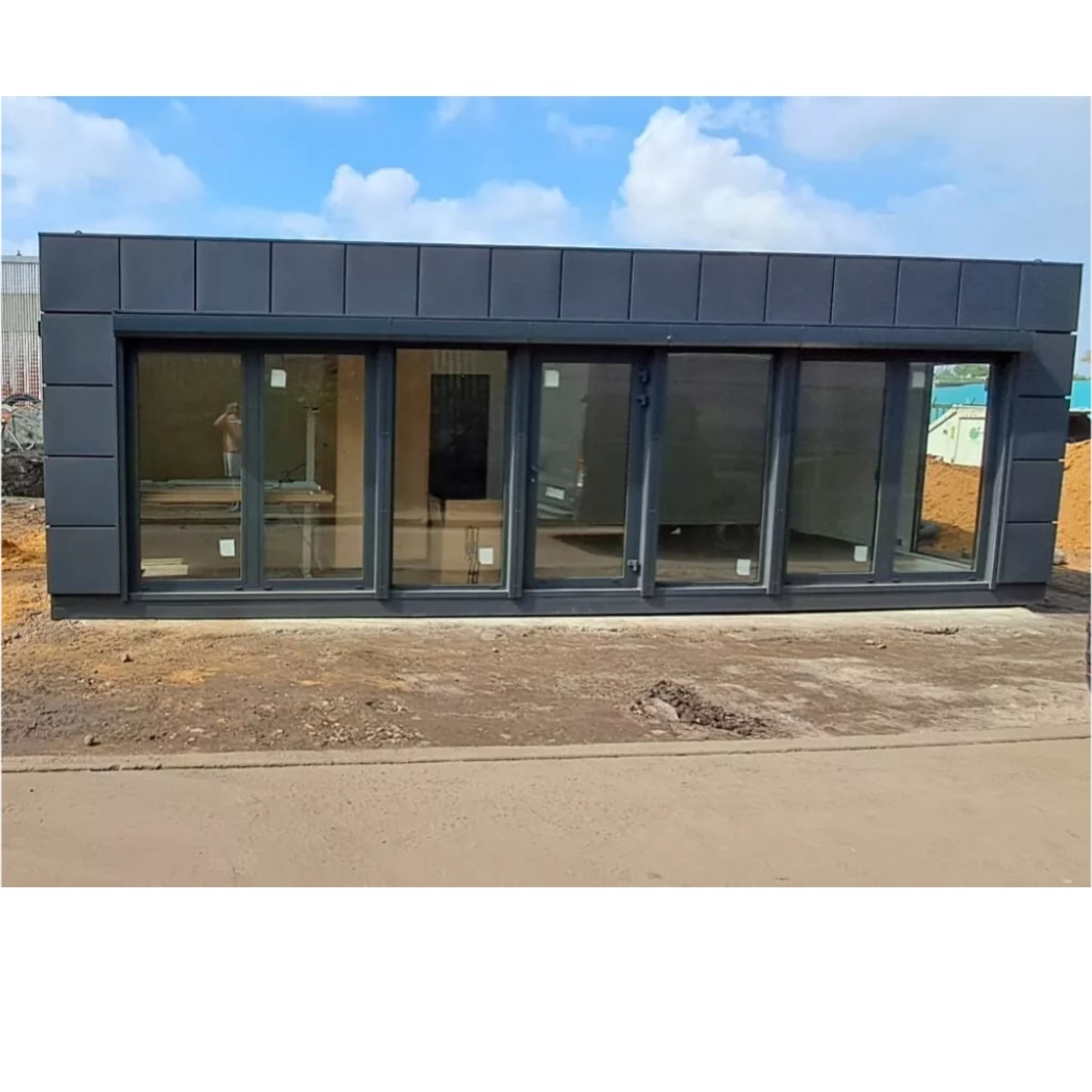

Permanent small single storey prefab metal office on concrete base. Has metal feeder pillar adjacent for supply (tncs) . The feeder pillar has 32 amp mcb and switch. A person can touch both metal building and feeder pillar at the same time as its only 30cm from building.
The building comes with 32 amp female commando socket externally which feeds small rcbo consumer unit inside building. Inside walls are sheeted with boarding and floors are timber with carpet. Inside a few sockets, lighting and aircon unit.
A male commando socket with 6mm flex has been left to finnish the connection. Length of cable is 2m .

Not the actual building but similar. Supply is fed directly from abc box on wooden pole to feeder pillar .

Not a trainee . Jib grade senior electrician. Site is spammy on phone probable pressed something incorrect. Yes I agree it would have been much better to run armoured but not what the developer currently offered. Probably will do this but was interested in seeing the answers and as can be seen many varied thoughts on the subject. Thank you
