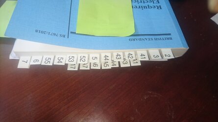

I just do this ^, I use my label machine and mark key pages like this, so if I am looking for say info on bonding then I would know this is section 54 and go straight to that section, and can also see where the section stops – it’s a few pages so finding anything is quick.
If I can’t remember the section – I know it’s selection and errection – so go to section 5 – which is the contents see it’s 54 and go there, even if I had no clue I can go straight to the front index and see the section/subsection etc. – as a result I can usually find the correct bit very quickly.
The issue with highlighting a book, is that after a few uses the only parts that actually stand-out are the non-highlighted bits!
Also I have seen people jump straight to a section – seeing the highlighted bit, and using that; the issue is that that highlight was for a specific question or purpose – and can very well be wrong in that instance!
To me going to the section quickly is far better that searching for a random bit of highlighting – if it takes me 2 seconds to get to the right section within a couple of pages, a brief speed-read and I have the answer to any question fairly quickly.
