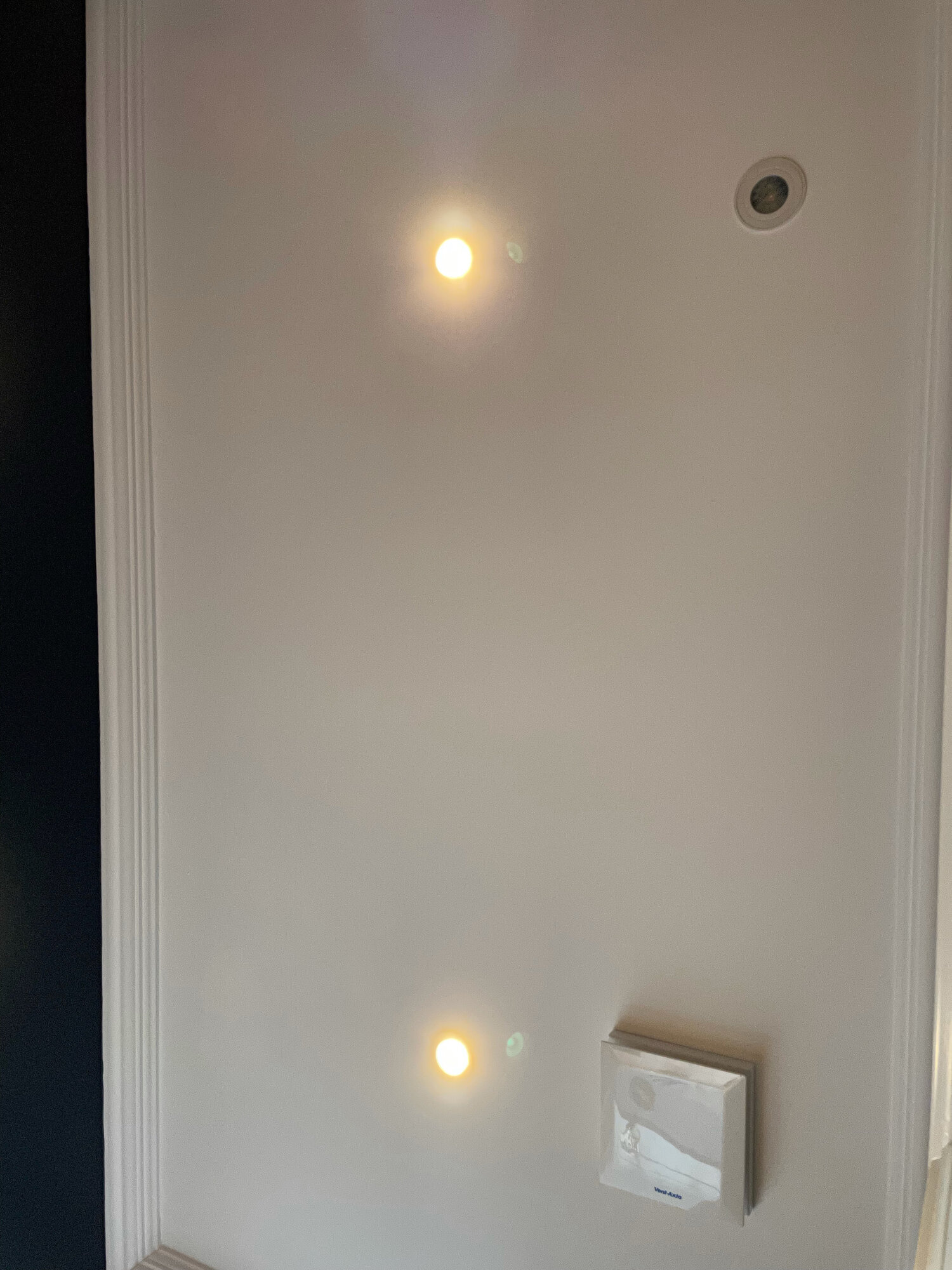

I have a ceiling PIR motion sensor fitted in my cloakroom that sometimes causes my kitchen lights to turn off when the sensor is triggered. Basically, if my kitchen lights are on and I walk into my cloakroom they sometimes switch off. This doesn't happen all the time. The PIR itself seems to be working as it should as the cloakroom lights always come on when the sensor is triggered. The kitchen lights are all on a dimmer switch. I know nothing about these things and the electrician who did the installation is also baffled and didn't believe me until I showed him a video. Unfortunately, he is not willing to help. Any suggestions as to why this would happen would be greatly appreciated. I'm more than happy to provide more information if required. Thanks!

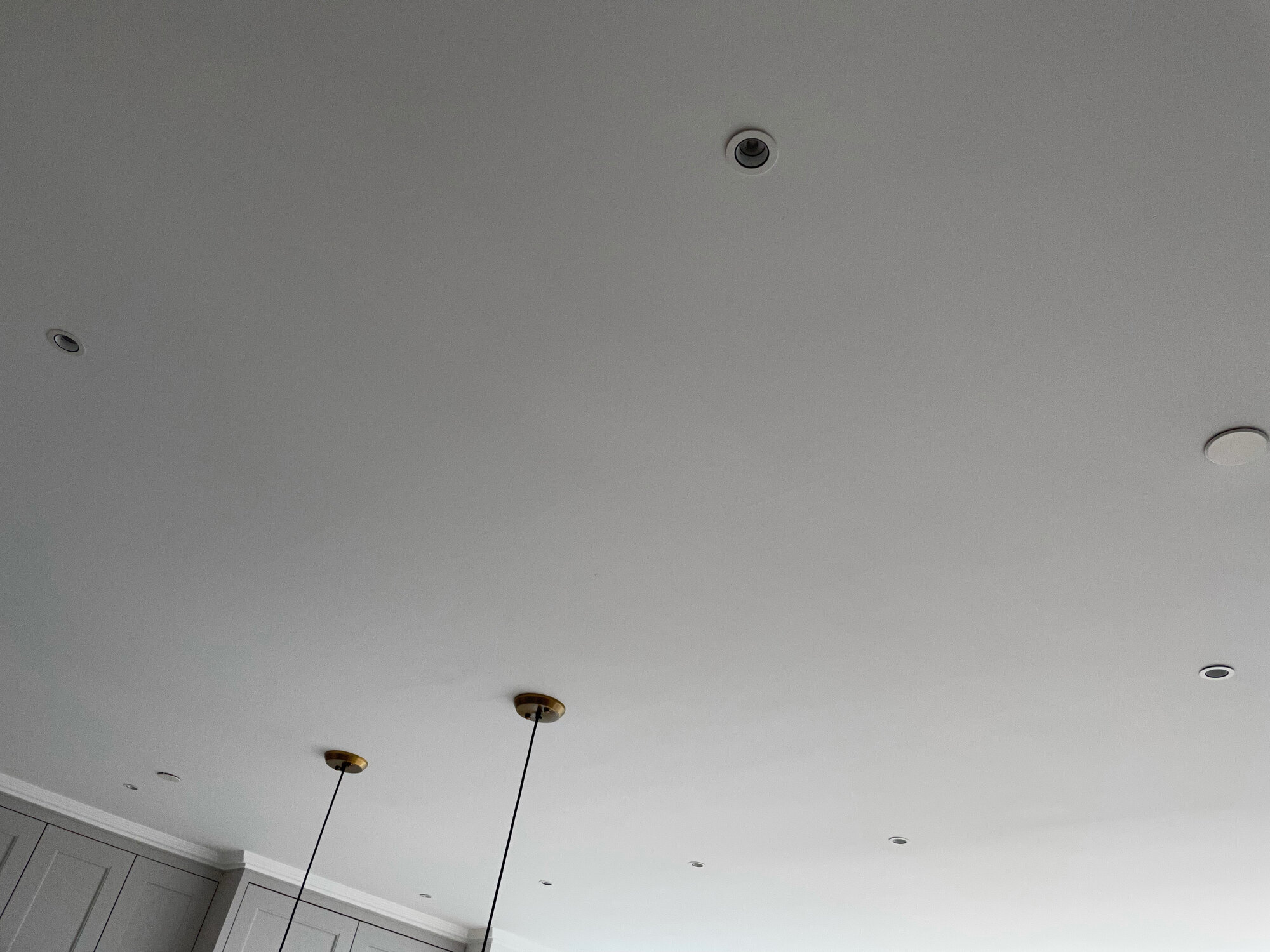

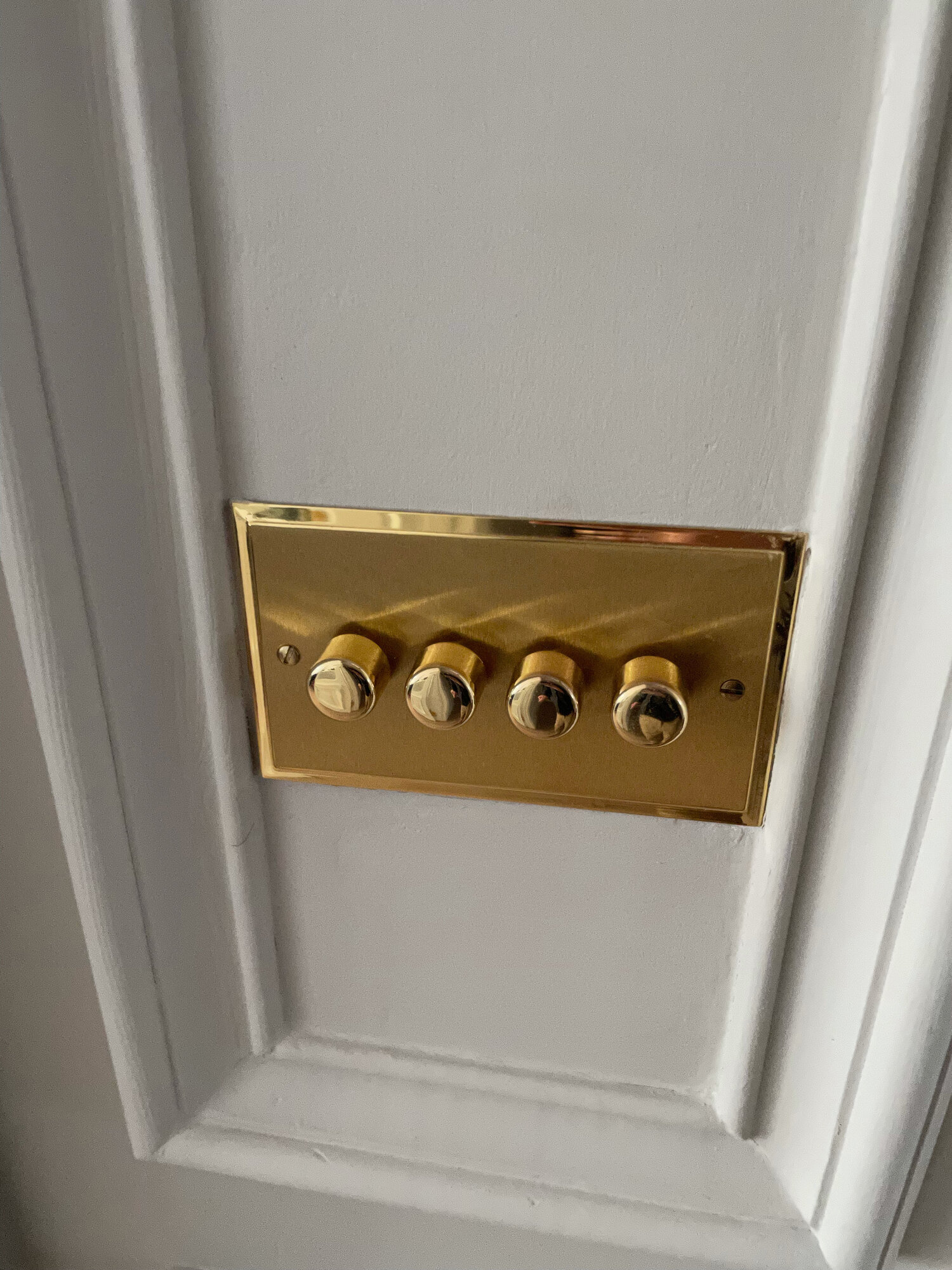

Thank you very much for the initial replies. I've attached some pictures of the LED lights and dimmer switches and a video showing the fault. There are 2 dimmer switches that operate the kitchen LED lights. I guess it's always going to be difficult to pinpoint the exact issue from a few pictures but at least I could relay your suggestions to the electrician that did the installation. Thank you

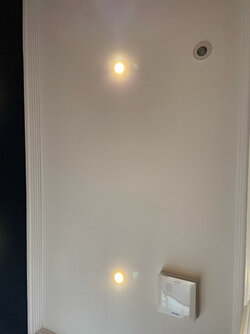

If you experiment with the kitchen switches - turn the lights off. Then try turning them on with one of the switches and see if it happens. Then turn the lights off at that same switch and try turning them on with the other of the two switches and see if it happens. You might find a pattern.

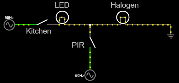

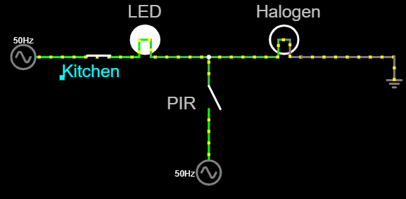

If they've ended up being wired in series with the kitchen lamps being LED and downstream of a cloakroom halogen then this could happen. You'd never know the cloakroom was dimmer than it should be as (I'm assuming) there's no obvious way to compare them 'side by side'. So everytime the cloakroom turns on it's effectively at 50% and the LED's just shut down. Simple fault, simple solution - and suggests a numpty installer who didn't test properly!
I was just messing about and arrived at virtually the same thing, I suspect something like this has been done, effectively making a voltage divider circuit:
https://tinyurl.com/yhtkp6wb if you want to play with it.
