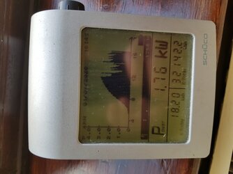

Hi,
This is a 10 year old 10 panel installation, recently output has been droping and somtines reaching zero mid afternoon. I think it is a sunnyboy inverter. Does it look like a panel, inverter or high mains volts? Could I have names of installers in West Yorkshire who may be able to help.
Thanks

I am pretty sure that the hand held monitor in your photo will tell you any fault codes aswell ?

The picture shows a 'SunnyBeam' blue tooth monitor and, as JD6400 has said, the monitor will show the error code by using the rotating toggle button on the light of the 'gadget'.
The picture shows that you are at the 'power today' display, so I will take you forward from there.
From the 'power today' display point press the toggle button again and it will take you to the 'Main Menu' display which will show you a number of options (Plant view, Inverter views etc). It will also show and 'Events' option.
Toggle down to 'Events option' (by rotating thr toggle button) and press the toggle buttton. The monitor will display any 'events' recorded against the inverter.
If there are any events shown, toggle down to any event and press the toggle button which will then display details of the particular event (Date, start/end time , elapsed time etc).
It will also show an error code (eg PE conn missing etc) which can be used by the engineer to identify the problem.
Hope this helps and hope you get things sorted quickly.
