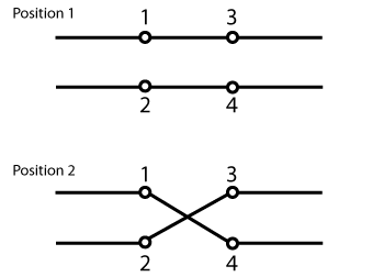

You are right - double pole is an intermediate switch or a main switch or FSU for example
2 way is a light switch.
I think that comment is wrong I would never class an intermediate switch as a double pole all the do is connect opposite connections together in either of these patterns II X please correct me if I am wrong ?
An intermediate switch is anything but double pole, it functions as vjsmarwick says. A 2 way switch isn't double pole either. Light switch are generally single pole.
Intermediate switch
2 way
