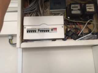

Hello. We are doing a refurb for an elderly lady and her family. Its a Victorian house. the local network has said it will upgrade fuse to 80A or 100A depending on capacity etc. she needs more power due to electric showers, stair lift, and our electrician will upgrade tails. But there is a mystery.
She has two meters. both old analogue ones with the rotating discs. they look ancient. one does not move at all. the other has a rotating disc moving at same speed. regardless of what is turned on etc. and the dials are stuck also. the disc just moves at same speed. Our electrician says both meters are live.
she has been paying a direct debit for years and nobody has come to check meters for years.
she has had 5 certified electricians do work on the house over the last 15 years. rewiring, new consumer board, two kitchen companies with their electricians have all done work near the meter board. Nobody has mentioned anything. she also told us that the DNO sorted the cut out as it was leaking bitumen and came out and sorted that out for her a few years ago. any idea what is happening?
if the meter is faulty the supplier should come and exchange but they cant do anything for months and we do not want to leave her with upgraded tails from a meter which clearly isnt functioning. is it normal for these old meters to do this? can our electrician change the meter and then inform supplier?
any suggestions would be helpful.

thanks for the reply. well the DNO came three years ago and sorted the cut out leak. Our electrician said he could change the meter and inform the supplier but according to you, the DNO can only do it. What is odd is that apparently these meters have been faulty for some time. do you know why there would be two meters? and also the disc on one rotating at the same speed regardless of consumption? is that normal. its a old Landis meter.
Can you post a picture of the arrangement? Showing both meters in same picture and fuse box if possible.
As well as a good photo, can you time how long it takes for the disk to rotate once (or X times if going too fast to time easily)? It might give us an idea of what load the meter has (or thinks it has).

fuse.jpg thank you. the fuse box photo is from the DNO who did the fuse work 2 years ago when there was a leak. according the lady here, they promised to come out and sort the whole box but never came back. We are not sure if the fuse head is good enough as it is to take a 100A fuse? meters.jpg
I would call the DNO about that cut-out, it looks in terrible condition! Better still send them a photo!
Can't you post a better photo of the meters? To get the disk factor mentioned above from it.
The old meters varied in terms of revolutions per kWh so dont think the number of revolutions at any one time will prove much.
It should however increase with loading so if at a constant speed regardless of load, can only think it is an internal fault that should be reported to the electricity supplier!
Clearly a 3 phase head which might account for the other single phase meter, although only one fuse carrier would indicate that if it is live it must be off the same phase so probably 'Off Peak' meter prior to a 'teleswitch' that has previously been removed!
amazing how much we learn on this forum in such a short time. never heard of a teleswitch before and neither had any of my team. even our electrician was confused! the lady here has no idea about it. Are we saying that an entire radio unit has been removed at some point? or is it some simple switch? There does not seem to be an large gaps anywhere.
Judging by the age of the installation it may have been an old mechanical timer that was used to switch on and off the Off Peak supply, if it ever was an Off Peak supply but we don't really know from the info and photo's!
'Teleswitch' is a more recent version that can be switched remotely.
Wow that head is in poor condition and well overdue for replacement, leave the iron cover shut as it is covering very dangerous parts. If it is a 3 phase supply to the head, the screw terminals near the bottom will all be live.
Thanks. Well the DNO assured the lady they would sort out the cut out when they came to sort the leak but that was never followed up. That was two years ago so we will speak to them. our electrician said today that the last fuse carrier (on far right) in that cut out is actually live. No fuse in it. He said it is linked to a substation which is normal. We have no idea what that is but is it common to have a live fuse carrier like that?
