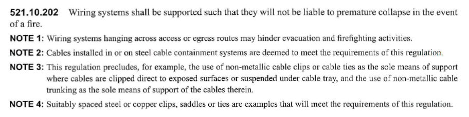

just brushing up on the 18th edition before I take the refresher this week. Iv seen Regulation 521.10.202 which basically states cables need to be supported throughout the installation in such a way they do not get in the way in the result of a fire. Does this mean cable clips on ceilings / upper floors are not longer used due to them being plastic?
In a nutshell yes there is a thread about this wait and I’ll have a dig about to find it here’s a report on fixings makes good reading if your looking to see which fixings to use

This regulation has come about as a result of the deaths of firefighters who became trapped in cables which had fallen down in burning buildings.
The coroners in these cases made the recommendations.
Your post is the first I've heard of any electric shock incident related to this.
I think note 3 makes it reasonably clear, although I did have to check the meaning of 'precludes'!
You can't use non-metalic fixings as the ONLY means of support where cables are clipped to exposed surfaces, I take this to mean that above plasterboard (i think standard board is 30min fire rated?) it is fine to use plastic clips etc.
Think about old pubs with all the cables just clipped to the exposed joists etc - big no no now.
Non metalic trunking as sole means of support is not allowed - so must also use metal fixings within the trunking.

true, ive seen and used the metal clips designed to go in trunking, whats the solution for plastic conduit?
Use metal. Metal saddles on plastic conduit have been used for years by fire alarm installers. You can get powder coated saddles to match PVC conduit too.

I think premature has the obvious meaning that the wiring system doesn't fall before the elements it is attached to fail.
So if the ceiling is down, the wiring can be down, but if it was almost like a trap where the wiring is supported by plastic supports that melt when a fire comes in, that is premature.
