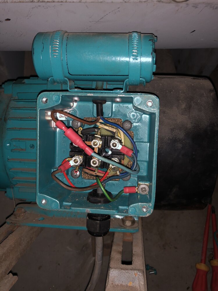

If I have a 240/480 volt dual voltage single phase motor connected by 2.5mm 2c+e to an isolator and then just 1mm flex coming out with active, neutral and earth connected is it possible the power supply to be 480v or is it most definitely 240v

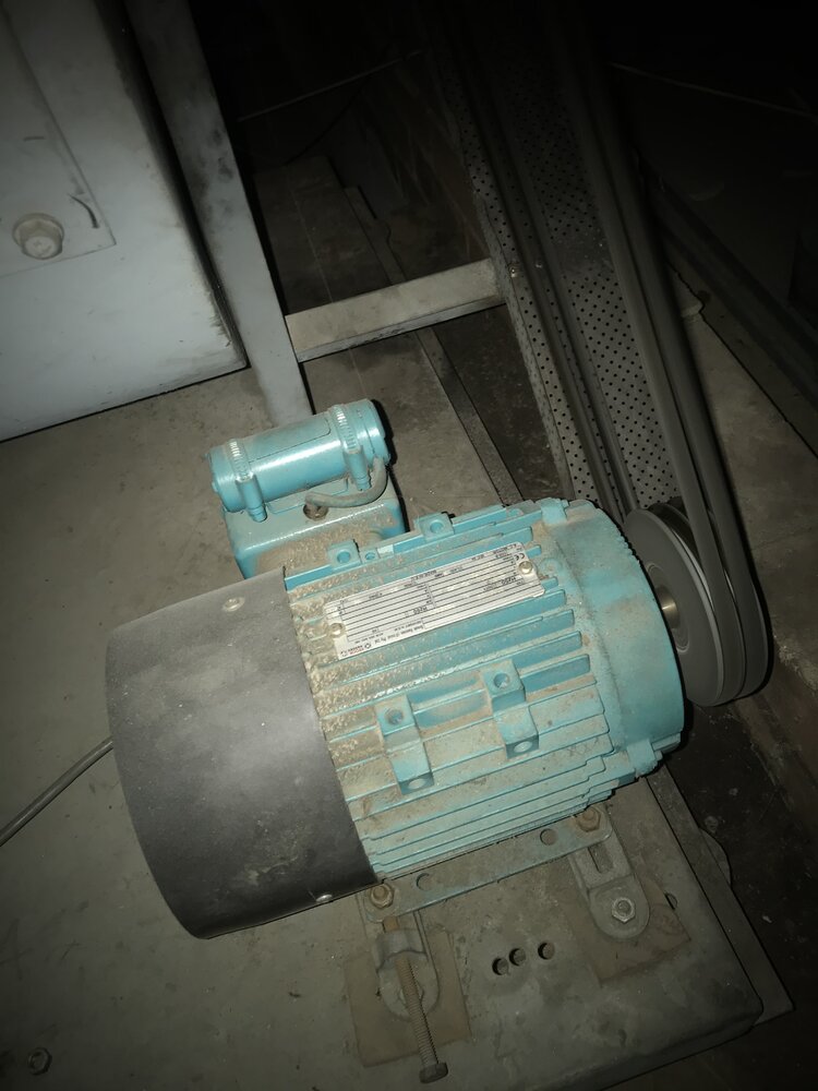

There would be three wires in either case. If it is 240V, they will be active, neutral and earth. On a standard split-phase 480V system there would be two actives and earth, with no connection to the neutral. You can usually identify which voltage the motor is set up for, by comparing the positions of wires and links in the terminal box with the diagram that is usually inside the lid. If in any doubt, post pics of the above plus the data plate.

here are some photos

View attachment 58668View attachment 58669View attachment 58672
Justin that is a dual voltage motor but I cant understand the configuration of the brass factory jumpers which could possibly go phase to phase as stated above the name plate should have all the info you need to know. It should read 3 phase or single phase motor. I’ve never seen a 480vac motor that wasn’t 3phase and the flex is no factor at all

Justin we need a photo of the underside of the terminal cover lid, that's where the wiring diagram is often found.

Megawatt, it's definitely a single phase motor. 240/480 split phase is common in rural Australia and the big capacitor is a give-away. Our industrial 3-phase is generally 415V.

I am concerned that it does look like it's wired for 480V. If you can get a pic of the underside of the terminal cover it may well have the wiring diagram, but I guess what you posted is all the info you have.
There seem to be six leadouts from the windings, indicating that there are two sections of main winding but only one capacitor winding which would be wound for 240V. For 480V operation the capacitor winding is connected across half the main winding, which serves as an autotransformer. An old UK convention was main winding = red/black, aux / cap / start winding = yellow/blue. If the second section of your main winding is brown/white, it all makes sense.
I've sketched how I think it is wired. Assuming the links are set for 480V in your motor, I've shown those as dashed lines. The red/black section and brown/white sections of the main winding are connected in series, with the blue/yellow capacitor winding in parallel with the red/black section only. The 240V link positions would be as shown by dotted lines, with all three windings in parallel. Even if the winding leadout colours don't follow that convention, for 240V I would expect to see either active or neutral connected to three windings, which you do not have. Therefore I think it's set for 480V.

thank you for all this information and your sketch it is very useful to me and I am returning to the site in a few days to investigate. I am under the impression yes it is wired for 480v but 240v has been connected and run on this motor for its life time, if this is the case what would the down side be of the motor efficiency?
The stall torque would be drastically reduced and the speed also low. With some types of load it wouldn't even be able to start, so unless the load is very light I am skeptical about whether it could have been used for a long time on 240V while wired for 480V. Of course, this might be the reason you have been called in to replace it. What does it drive?
Remember that my sketch is only based on what I see in your picture and general knowledge. I give no guarantee that it is correct.
