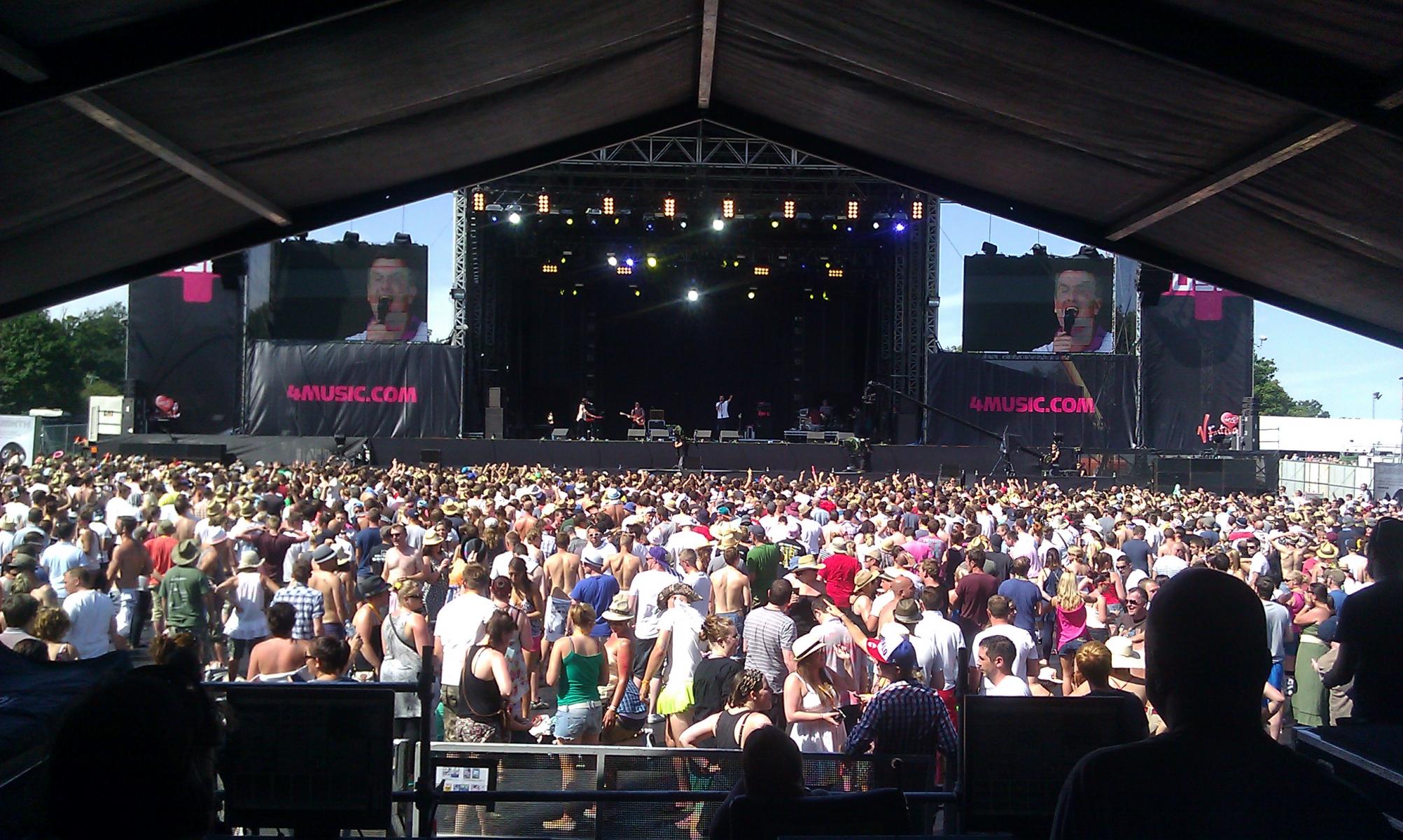

These three were Friday night at Lowlands festival (Holland). Roughly 100kW of lights on that stage.
And this was V Fest Chelmsford the next day. Also did Stafford but no pics.

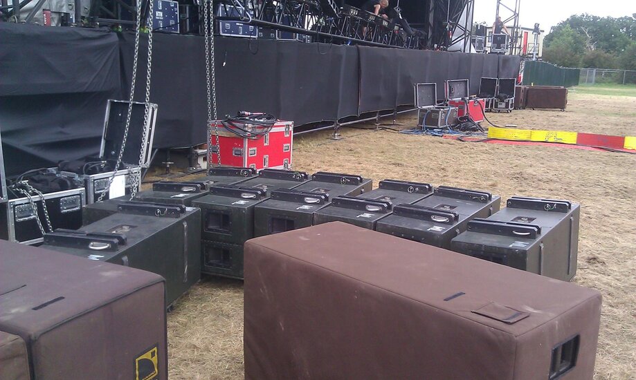

Dean - I'm a lampy not a noise boy, but modern PA stacks are 'line array'. Basically, all very ultra-tech but each cabinet will have a dispersion pattern of typically 100-120 degs horizontally, but only 3 or 4 degs vertically. So, the principal is that by adjusting the rake on each stack you can hit very specific areas of the crowd but with minimal interference of waveforms (something like that, anyway). Each cabinet has it's own amp channel (typically around 2000W low impedance) so cumulative power plus the accuracy is staggering. Rarely do they get run at anywhere near full whack - in fact, that's the idea - the ability to clearly hear but without being dangerously loud, and the level at the back of the crowd is more or less the same as the front (as the array is configured, obviously). Each 'stack' is normally around 500 kg in weight, and I think individual cabinets vary price wise from around £4k up. A full system like those in the pics would set you back easily a quarter million by the time you've bought all the amps (£3-4k each), crossovers, system controllers, distro's etc. And expect to pay another £100k for a professional digital sound console.

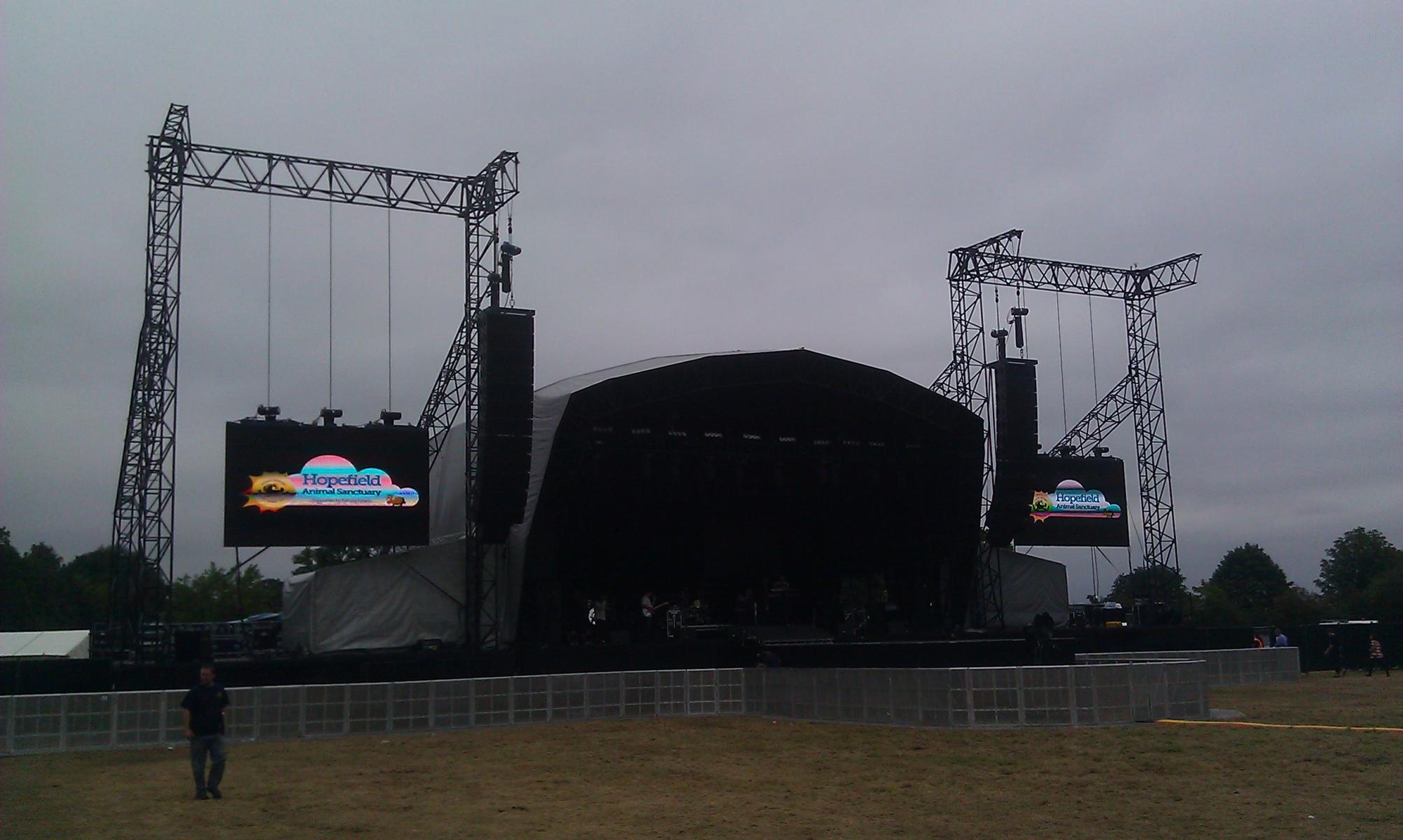

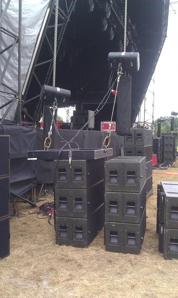

Especially for Dean - been taking some piccies out on this weekends job (Olly Muirs & Pixie Lot). I'm here on a rigging call rather than sparky/lighting, so in short if it's hanging out of the sky then I've put the motor there that it's hanging from.
IMAG0603.jpg This is a stack on the ground before flying. They get hung 2 or 3 at a time.
IMAG0604.jpg On custom cradle arms attached to 2 x 1T chain winches (that I put there)

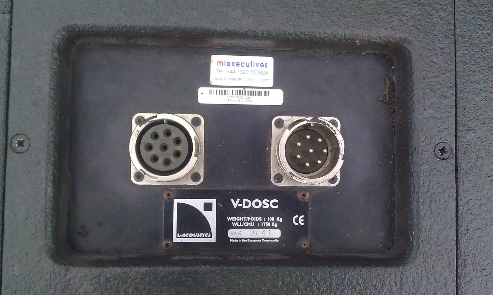

IMAG0602.jpg Each individual cabinet (on this make/type) is what's known as a 4 way active system - so that's 1 x channel for High, 1 x High Mid, 1 x Low Mid and 1 x Low. Each frequency band has it's own separate channel of amplification. The drivers inside the cabs are typically either 8 or 16 Ohms, so that by using a link in/out system you end up with them working in parallel down to 2 Ohms which is the maximum (minimum) impedance that a professional power amp will go to.
There is then also a separate system again for the subs (20Hz > 100Hz ish normally) which usually just sit on the deck.

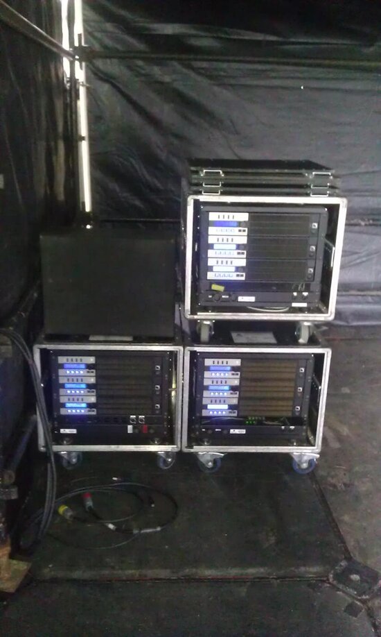

IMAG0605.jpg This is ONE amp set up driving one side of the stage - so that's 18 ch's of 2-3000W low impedance each. The composite audio signal comes in as a conventional analogue line then gets split by an incredibly complex and expensive box of digital algorithms into whatever frequency bands the system needs. In todays case, 5 ways (I think). Each of those 3 racks will run from a 32/1 ceeform, so that's 90A's roughly a side if they're flat out (never are).

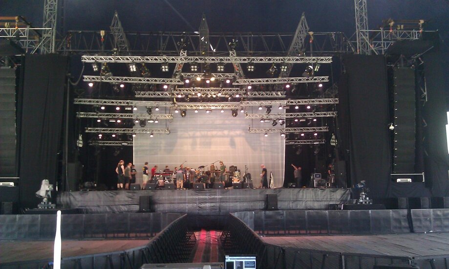

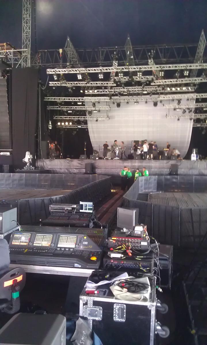

And the big picture end product: IMAG0608.jpg

View attachment 14329 This is a stack on the ground before flying. They get hung 2 or 3 at a time.
View attachment 14330 On custom cradle arms attached to 2 x 1T chain winches (that I put there)
View attachment 14331 Each individual cabinet (on this make/type) is what's known as a 4 way active system - so that's 1 x channel for High, 1 x High Mid, 1 x Low Mid and 1 x Low. Each frequency band has it's own separate channel of amplification. The drivers inside the cabs are typically either 8 or 16 Ohms, so that by using a link in/out system you end up with them working in parallel down to 2 Ohms which is the maximum (minimum) impedance that a professional power amp will go to.

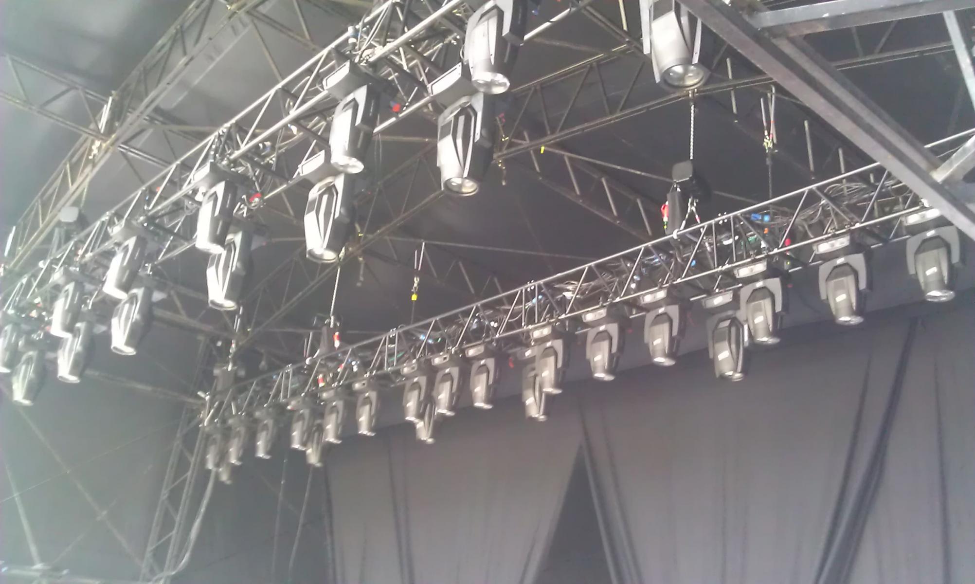

Well, we're still a ridiculous waste of diesel, but not anywhere near as much as we used to be. The lighting rig today only has 12 ways of dimming for some crowd blinders - the rest of the rig is intelligent lights. So instead of 3 artics full of 1kw CP62's (PAR64s) there's half a truck of 50 x 1.6A moving heads that only really draw power when they're 'doing' something as the lamps inside are various flavours of halides all on internal ballasts and draw peanuts once struck. The audio boys have nearly managed to catch up for power needs, and on the really really big shows with delay towers etc often do.
