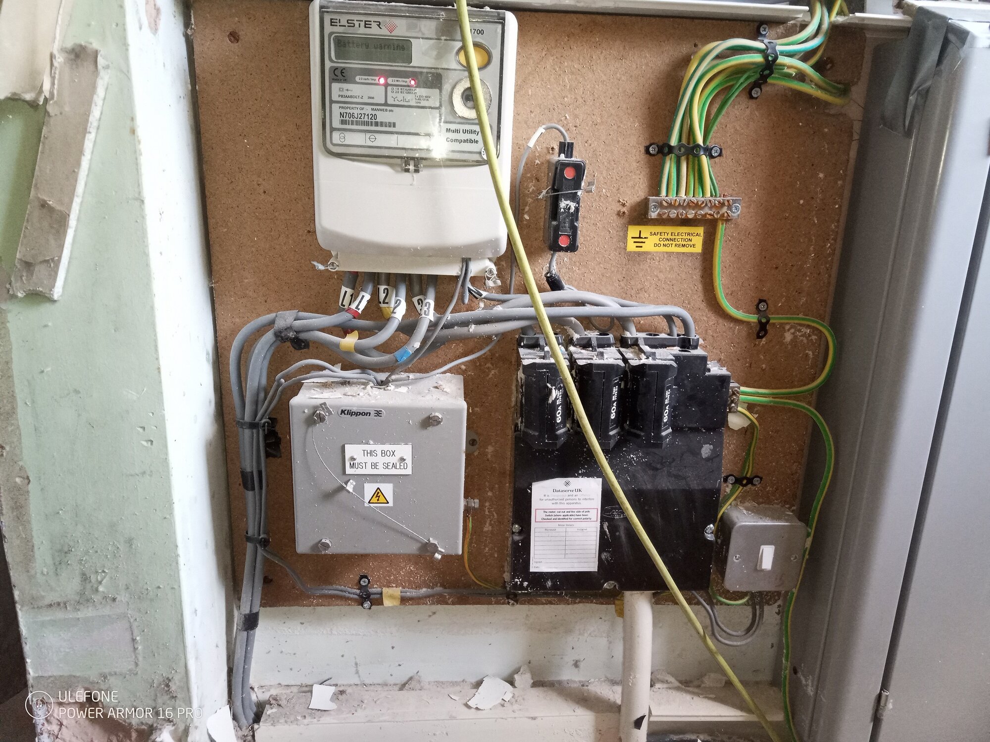

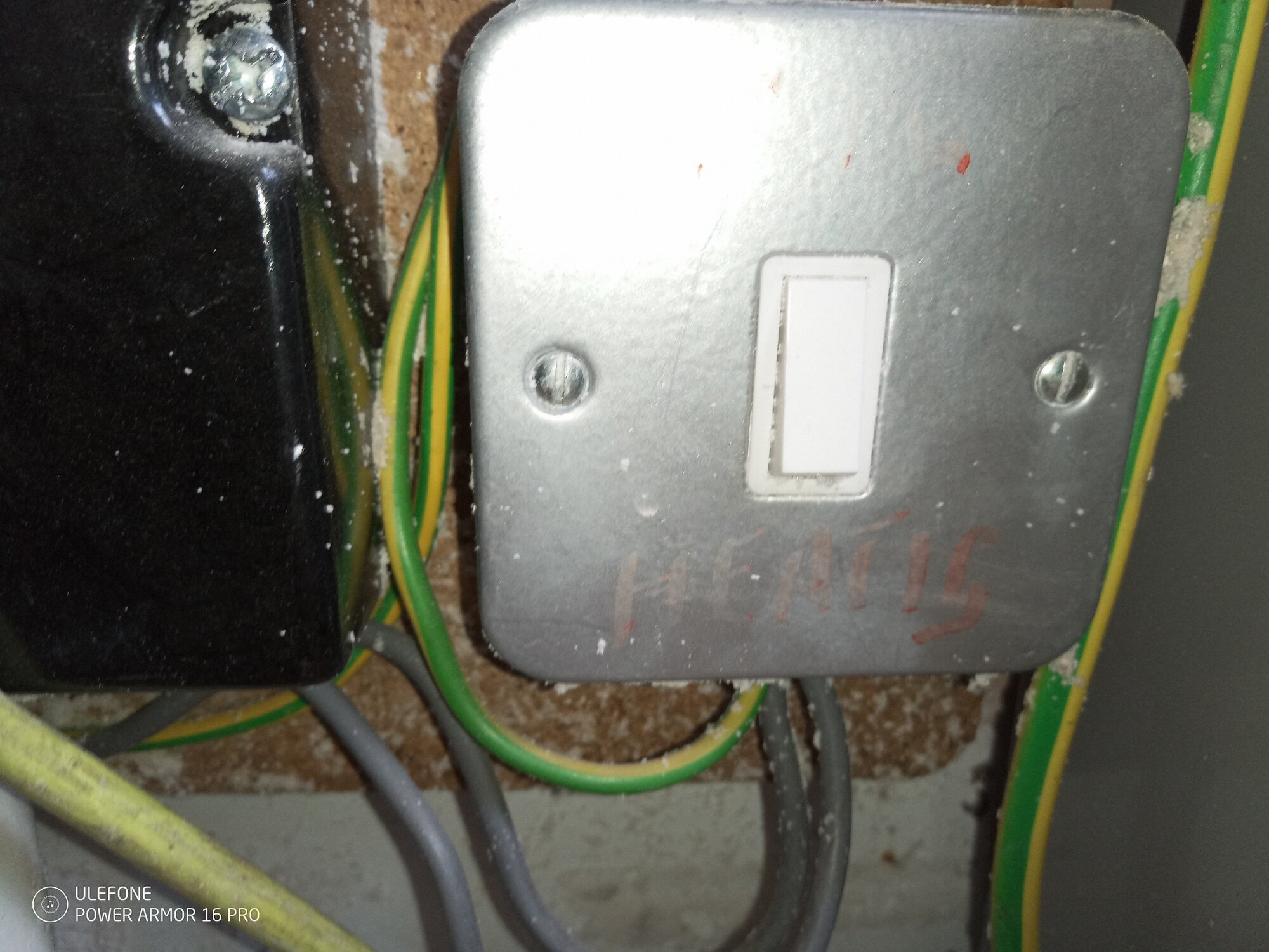

Its in a commercial set up with a poly-phase meter, the distribution board and switchgear were all quite old but the meter looked fairly new, it was the usualll 3 phase in and 3 phase out meter but underneath it was a sealed metal box with several 6mm singles coming out of it, one picked up the neutral, 2 went to the meter and 2 went to a 1 gang switch all inside the meter cupboard.
I've seen similar where a contactor triggers the meter into switching over to a cheaper rate but thats on single phase meters and it just switched the neutral to the meter, usually with just one wire into the meter. If it is some kind of night rate relay why would it have an overide switch of some sort.
The metal box looked like it was owned by the DNO because it has a seal on it and said do not open on it I think.

I would suggest it could be heating contactor(s).
Its hard to tell, but it looks like the single fuse might have been connected to the cut-out and is now disconnected? My thought was some sort of time-switch for shared lighting (like stairways in blocks of flats, etc) so fixed load and not metered.
If you look closely the wire appears to go into the terminal of fuse1. The neutral coming from the meters neutral terminal, looping into the meters aux switch then down to the box. Perhaps the switch was to disable the contactor in the box during the summer? I assume there should be cables coming out the bottom of that box that are now removed?
