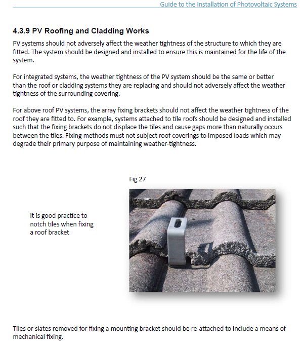

Shame they've not ground the back of the tiles out to accommodate the hooks - they're standing proud. A couple of clips on the external AC cable wouldn't hurt either. And is that a 17th edition (twin RCD) MK Sentry board?

What the hooks should look like to be MCS compliant:
(Had to do that on a 20KW install this spring .....200 tiles later...)

t is a pain and takes time, however we would have notched them., I've no doubt GavinA will have advice as to whether to leave it or get them to fix it. - They won't like coming back. However you don't want a problem over the next 25 years.

Worcester Do you still notch tiles with the REDTIP roof anchors
Yes and no! - On plain tiles, don't need to :) In fact our MCS inspection this year was on a HookStop installation.
Other tile types, yes we still notch if needed.
I was staying well out of this tbh.
but yes we'd always grind out the lugs so the tiles sit down as a matter of course. Tbh I'm never so concerned about the middle ones, but the ones around the edges I work on the basis that they definitely shouldn't stick up to the point where you can actually see between the 2 tiles into the underside... ie so that wind blown rain can't get in below the tiles.
