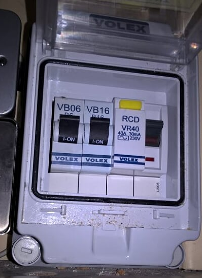

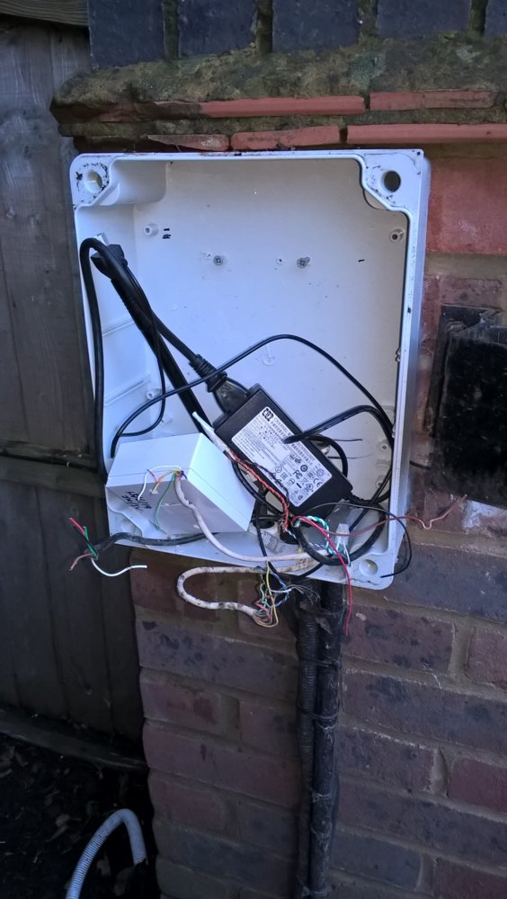

Hi all I have only recently qualified and would appreciate some advice re wiring PIR brick lights and surface mounted PIR lights on two electric gate posts on either side of sliding gate. My question is can I break into the incoming 230V supply to the gate controller if I use a fcu for lights on each post? Each post will have its own dedicated fcu. I would have to connect the spur to the supply in the controller box as the supply cable is buried under the drive. The reason for 2 fcu's is that there is a second 230v cable at the other pillar (for the remote) which originates from the gate (motor) controller box. This would save me having to bury a cable under the drive. So in essence I would be tapping into the mains on either side of the gate. The gate supply has its own dedicated 2way CU box which is RCD protected. Thanks for your help.

TBH tapping in is not ideal however practically it makes sense. If there's a fault then the lights and gate lose power, not the end of the world as the gates should be able to be operated manually.
I would use double pole SFCU for the lights so they could be isolated in case of an earth fault and also for local maintenance.
Thank you Strima! any idea where i can source a double pole SFCU with an ip rating of 55-66? Cheers!
youcan use a suitably sized IP rated ad. box to fit the SFCU in. summink like :
Thanks Telectrix I was looking for one that had an easy accessible switch but guess it would do the trick. And as there is already such a box on one pillar I will only need to fit one. Thanks for taking the time.

Thanks SJD very valid point to consider. If the 3 amp fuse in the SFCU blows without the incoming gate supply MCB tripping then presumably it wouldn't affect the gates. But if the MCB trips then the gate will have to be operated manually. Is this a sufficiently significant issue to bring in a new supply just for the lights? Or the alternative, solar powered brick and surface mounted PIR lights?

Thanks DefyG I appreciate your input. Yes so PIR and possibly dusk to dawn sensor is mainly for lighting up the drive for gate access. However the original installation which is now defunct had a switch inside the house. So client would prefer this option. However too much is involved in rewiring from the house. So other option is like you say a wireless remote. I doubt there is provision in the control box otherwise it would surely have been fitted when they fitted the gate which is now quite old. But no harm in asking the manufacturers. The cable running to opposite pillar is 3 core and there is an additional cable for the sensor. Thanks

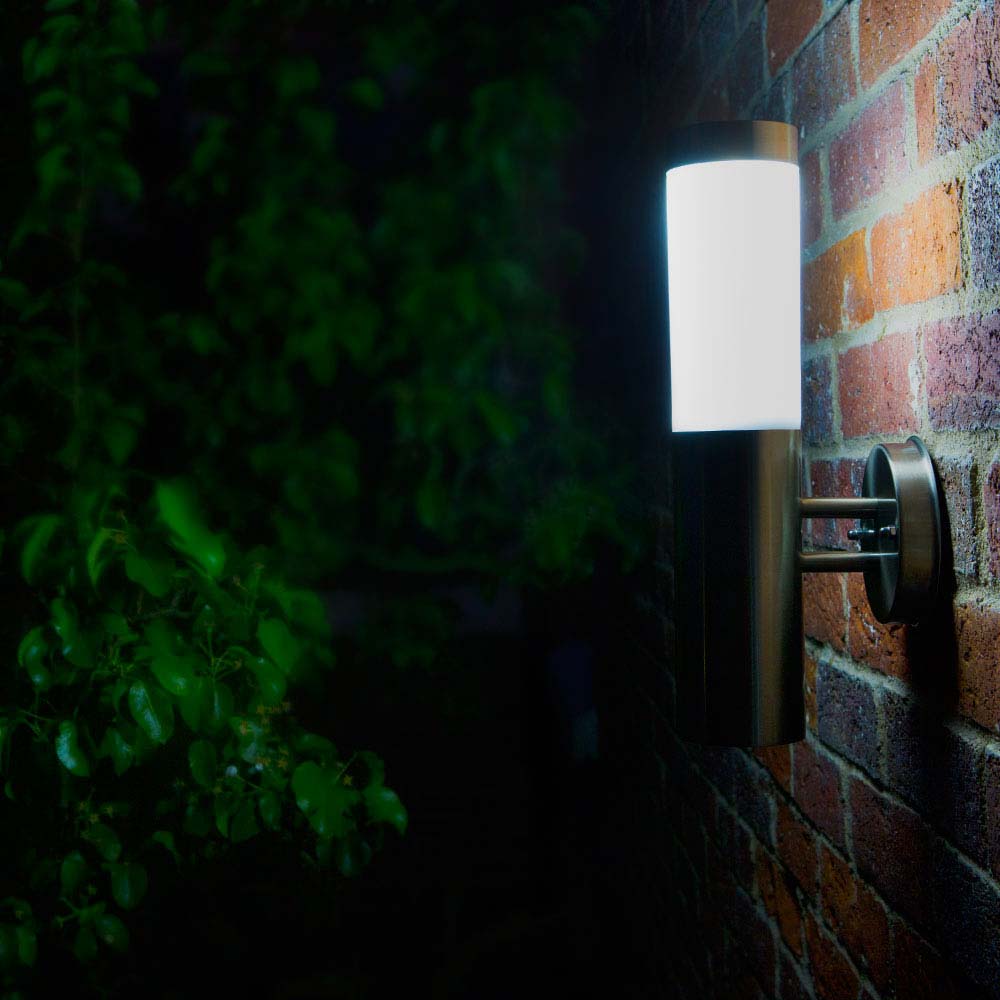

What do you think of solar powered option such as this?

Yes still a much cheaper option for client. At least I can give him some options. Thanks.
