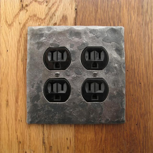

I am a crafter and I want to make a copper switch plates , as copper killks bacteria, and looks stylish, I think it would sell. I plan to waterjet cut copper sheets thickness 0.11 inch , than hand forged and patina, the look would be similar to this here http://www.houzz.com/projects/997617/wall-plates
What you think ? Would it sell in UK ? Did you see it before ?

I am thinking of bare copper with holes just like this one

The Pic provided is not BS standard outlets the UK sockets look very different, therefore the holes you need to cut would depend on the country you sell to and the brand of socket or switch you put into the plate, as there are thousands of variations then you cannot simply pick a hole template, hence you would have to get involved with a manufacturer of the socket/switches themselves.
