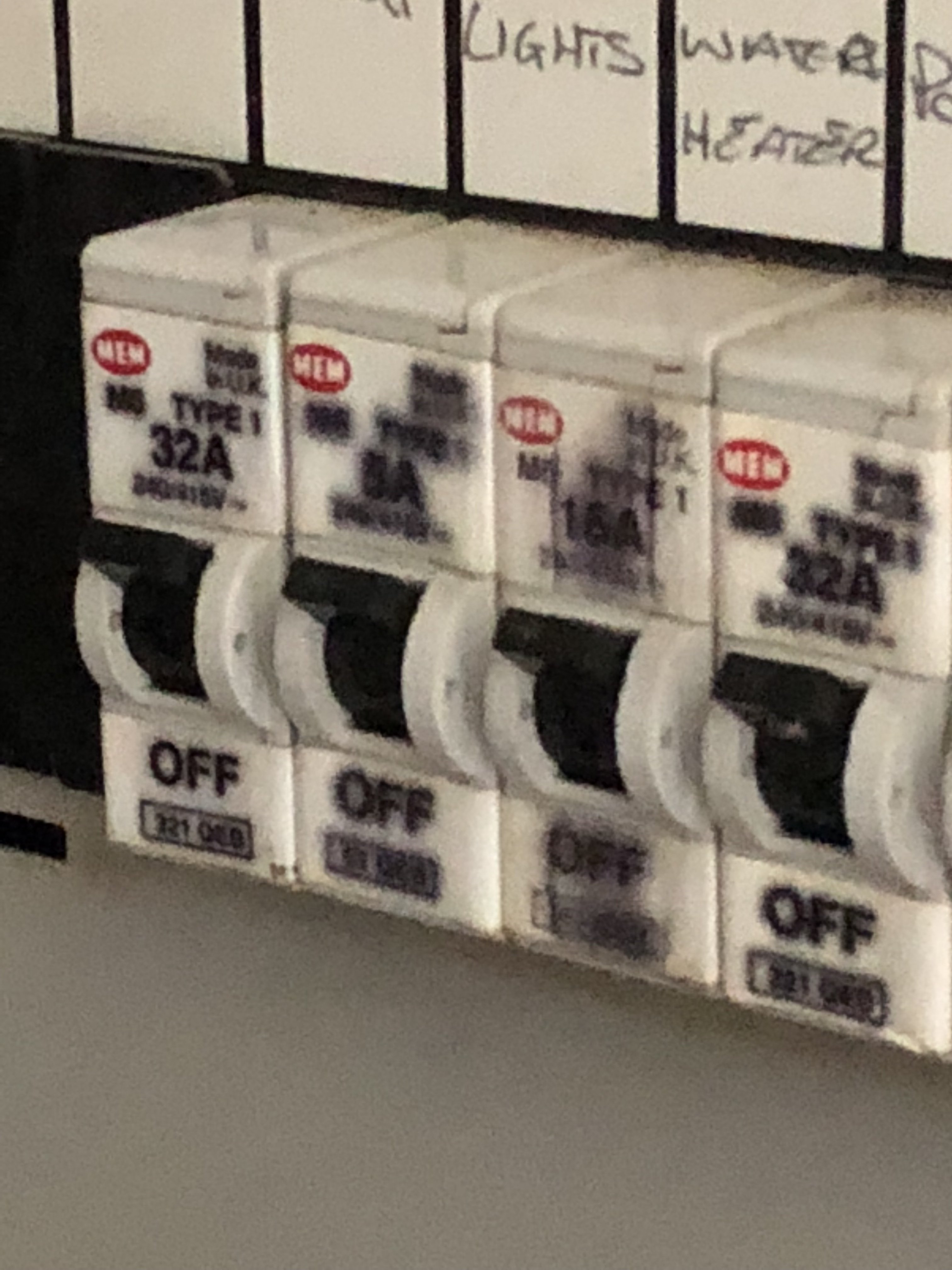

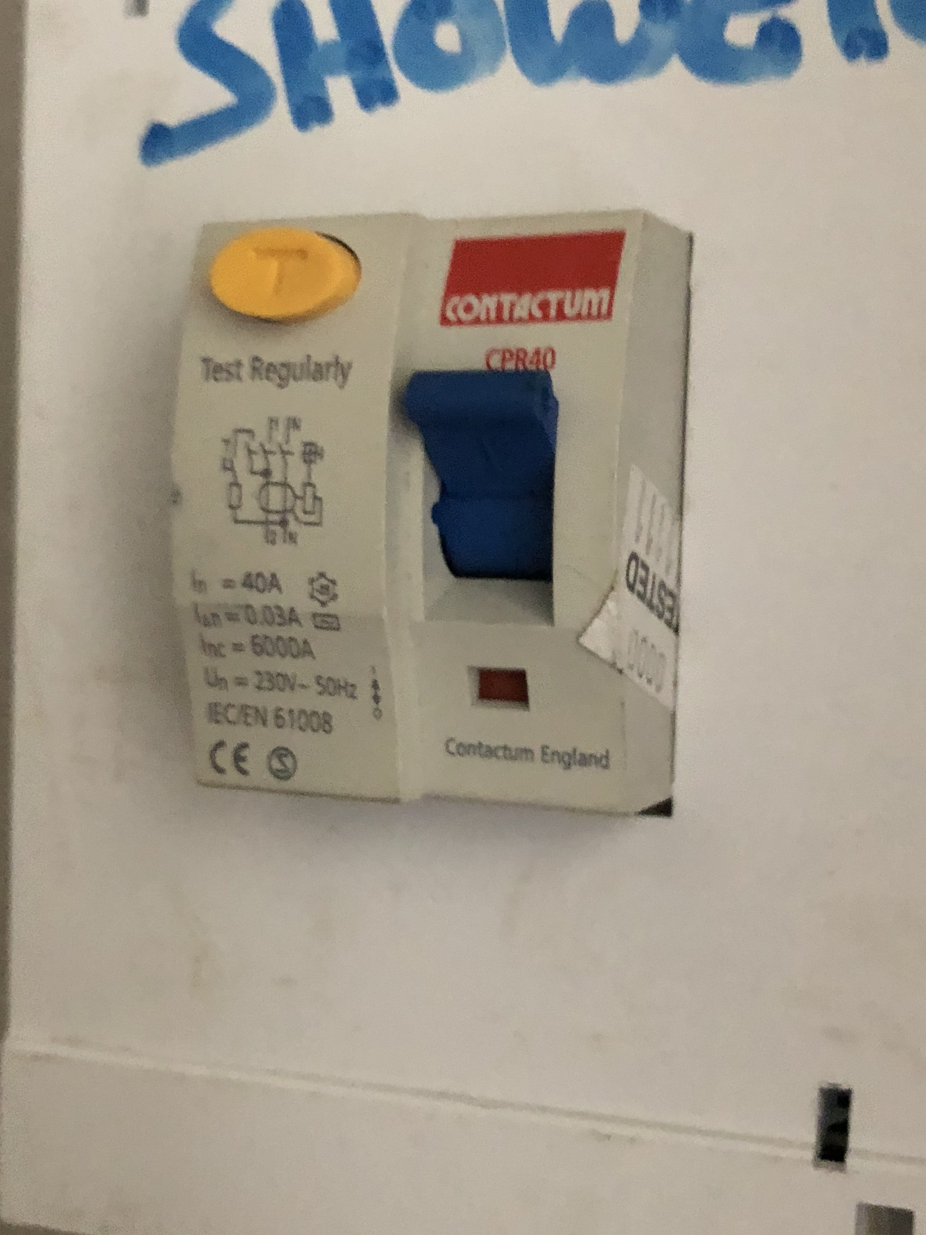

It’s just the shower that goes. That’s about as much as I can tell you. Sorry. Am clueless about this stuff. Looks as though the board was put in in 2010
Without being there it's difficult to address the problem, but usually the RCD will be connected in conjunction with a number of MCBs, but you say it's only the shower that doesn't work, this makes me think it's the MCB that is tripping not the RCD, can you post what is written on the device that trips? Or better still a picture of the Consumers Unit (fuseboard) showing the item that trips.It’s just the shower that goes. That’s about as much as I can tell you. Sorry. Am clueless about this stuff. Looks as though the board was put in in 2010
If the rcd is tripping best you get the circuit and the shower tested .... .
Probably cost you about £50
Then you will know where the problem is[/QUOTE
No certificates then, how or what did the shower guy do to check the wiring?Thanks. The guy from Triton is insisting no issues with the shower cos the guy checked the wiring. Sparky it is then!
That figures, after the Sparks has done what he can, please let the forum know what transpiredJust took the cover off the shower. Was a “visual inspection”. He certainly didn’t seem to have any kit with him
It's quite simple really Mate, the money they make from, say, selling 10 showers far outweighs the chances of 1 or 2 causing trouble for their customers.I got a sparky out. He put in a 45amp mcb so all seems fine now. I just feel like Triton could’ve handled it a lot better. I find it astounding that they would install a shower without at least looking at your electrics!
