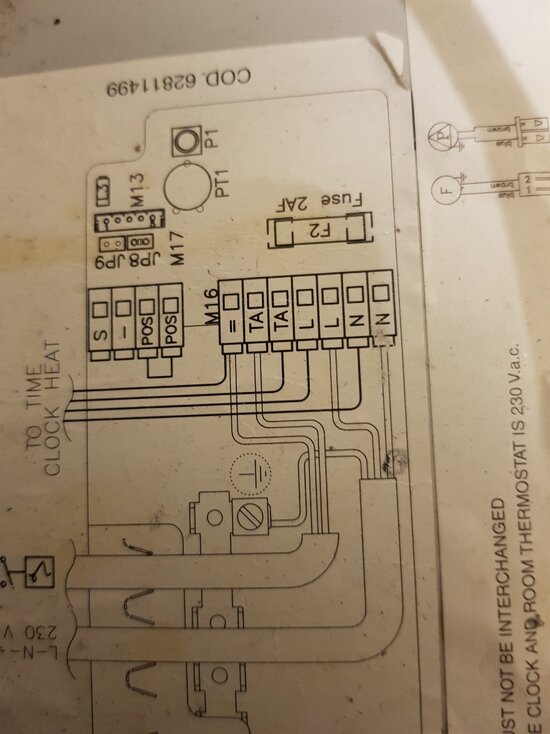

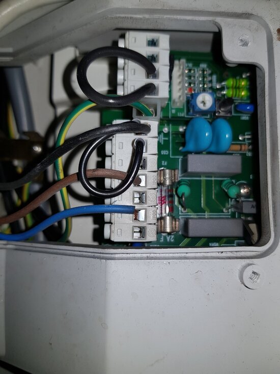

I'm trying to install a hive thermostat. I was able to get the hive receiver hooked up but I think I've made a mistake with the wiring as the heating will stay on continuously.
Can anyone tell me what needs connected to what?
I've attached the boiler board (It only has the old timer connected in the picture) and the two diagrams for hive/boiler.
Cheers
LNE are self explanatory. TA are your thermostat connections with the link removed to = as you don’t need the time clock connections with the hive.
