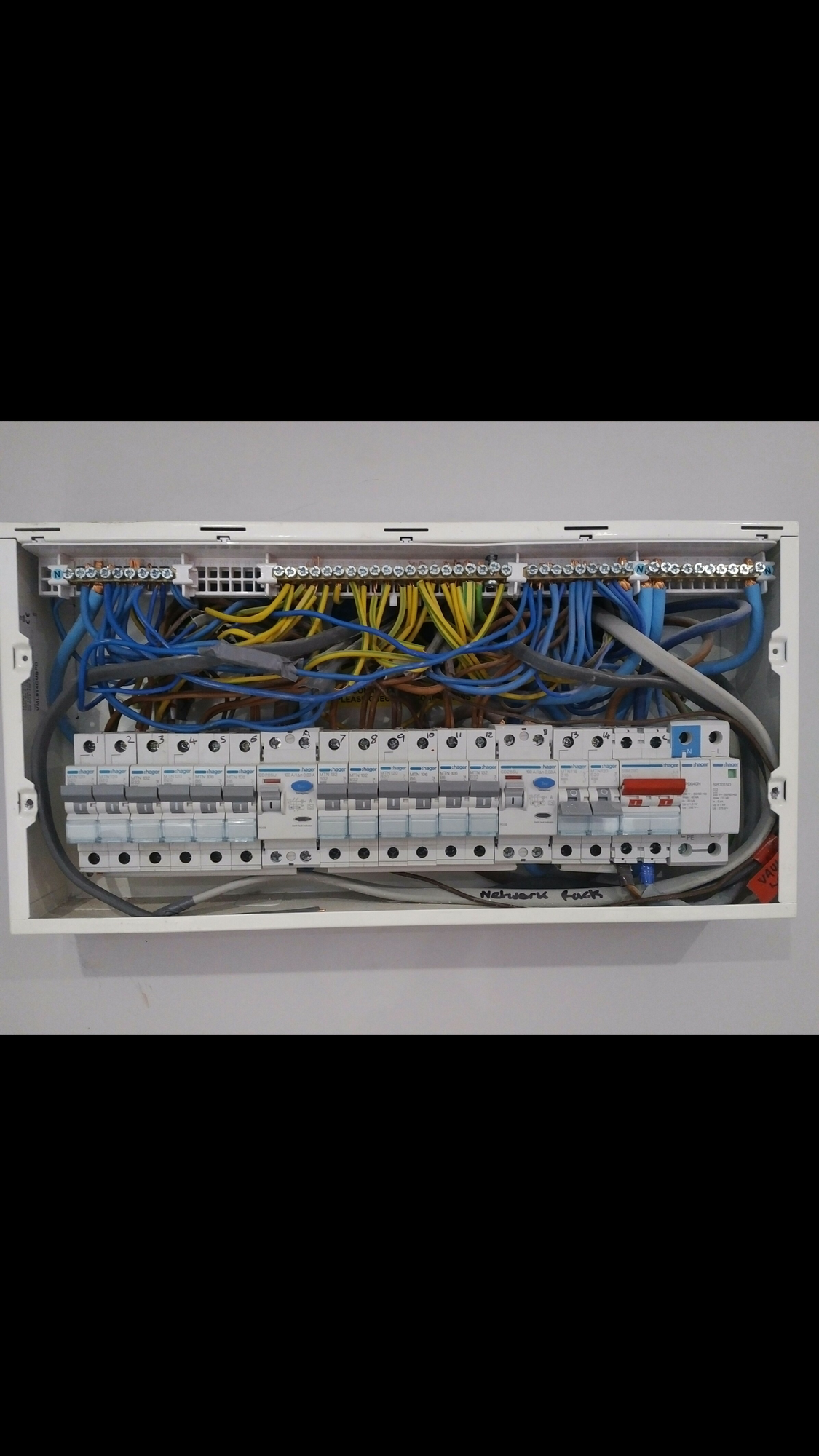

So would you be happy to test this rats nest that was done a couple of months ago?
And has some obvious faults without looking properly, the original installer wouldn't sign it off and then wouldn't answer the customer's emails calls or texts, mm wonder why!
I was going to attach a picture of one I did a week or so ago for a comparison but it will not have it!
Personally I will always do a neat job of everything I do, it's why I get so much repeat business.
Take pride in your work, do it once and do it properly!

Apart from some of the copper conductors being proud of the breakers, there is nothing “wrong” with it.
I agree that it could and probably should be neater but would it make it any safer?
part of me is playing the devils advocate
part of me is thinking conductors in the right holes, screws done up correctly, testing and certification in place, what’s the problem?

Neatness wouldn't make it any safer, but.
Hidden in there are some 1.0mm cables protected by 20mcb's and some 2.5mm radial circuits on 32a mcb's.
As well as cables left to fit and not enough spare ways for them.
There are also lighting circuits in with socket circuits it's a bit of a mess, there is also the RCD's maximum allowed leakage to consider, that's a lot of lights and sockets to hang off two RCD's.
And none of it is labeled properly.
I couldn't leave a job I'd done looking like that and walk away a happy contractor!

Hmm i take all your points and you are right but...does any of that actually get impacted by the wiring not being nice to look at?
Neatness and logical routing of conductors can help their identification and tracing and thus purpose which in turn may reduce errors at the time of wiring and later when say inspecting and testing. Neatness also suggests care and pride in a job well done and not rushed to complete.
For me I have always viewed doing a consumer unit as the one chance to really show your skills at doing a neat tidy job.
It doesn't have to be perfect but cores cut to a nice length and dressed in neatly , the correct sized sleeving used , tails neatly dressed in etc all make it easier for the next person to work on the board and hopefully keep it neat.
If you start with a rats nest and people add to the rats nests you just end up with a bigger rats nest and eventually your work ends up on here being called a complete rats nest

To be fair that DB/CU looks tight as hell
