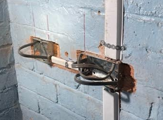

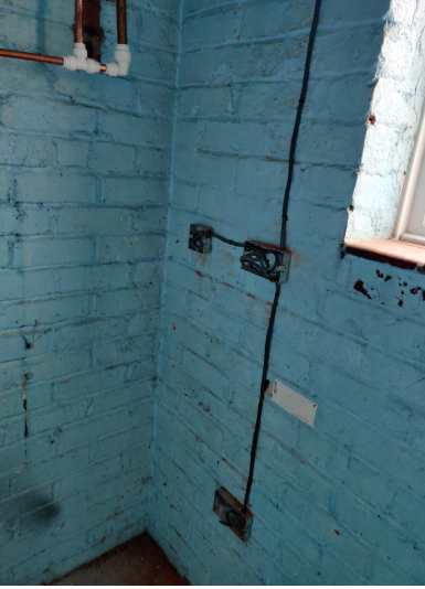

Yesterday my assistant first fixed this believing it was going to be dot and dab. It wasn't - the room is so narrow that the plasterer decided to float it out instead, so about 13mm once skimmed.
The plasterer wanted to finish off this last room this morning.
So last night I found myself working, and using the Metabo I sank the boxes in 15mm. I arrived at 6:30pm. I was at the pub by 7:40pm.
Pretty much every downstairs wall here is floated out in plaster. I've comfortably chased 25mm round conduit to a good depth with the Metabo. Worth mentioning the triple blade is a bit slower than most folks would be used to with a twin blade, but worth every extra moment when it leaves a nice clean chase ready for cables.

The triple blade is indeed excellent. I factor in a new triple blade every 3 rewires, not always required but they can be rock hard bricks that eat them quicker.
I regularly completely sink 25mm boxes in with it, and at max setting with extra patience (letting the tool do the work at its own speed) I've sunk 35mm in too.
The best think is how neat the chases look, and how the plumbers bolster and chisel effort looks so sloppy in comparison! A couple of customers have commented that electricians seem to take more pride in the things that remain unseen than other trades on the basis of some neat metabo work!
