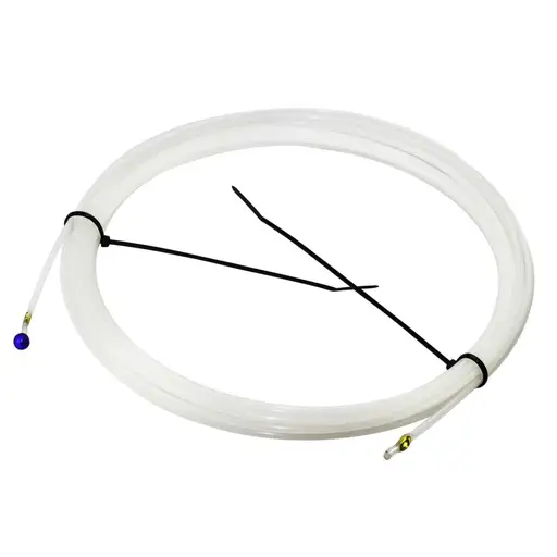

I use super rod kit , works well and if I need to pull some really heavy cables thrn I use them tu piYll
Used a Jack Russel once. Got him to run the full length of a loft conversion, behind the two foot high vertical walls, drawing a rope behind him.
i did once use an 8 year old boy.
(My grandson) was helping me fit a heater and trying to fit all 6ft of me in a small space to pass a cable through a hole was just not possible.
He did a great job, only took him 30 seconds to achieve something 10 minutes of my trying failed to achieve.
I not tried super rods but have a set of cheapo ones, very rare that i will use them.
I find that you can manipulate the steel to get in some places a rod won’t and everywhere a rod will plus they are cheap and lasts for years.
One tip is to cut off and make the loop smaller so that 1mm fits it snuggly never a need for any tape and very quick.
Great for downlights.
I'd say it's a combination of what's suitable and ... drumroll ... what you actually have with you.
I've heard of using a cat under floorboards - my experience is you struggle to keep them out anyway !
I dont like steel draw wires, reminds me too much of the old steel snakes we used to use for drawing wires into conduit, horrible things.
I just wish nylon snakes and super rods had been about in the 70s and 80s when I did a lot of house bashing.

Have you ever used the amtec type one ? It’s not round it’s flat and quite rigid and pushes on quite well.
