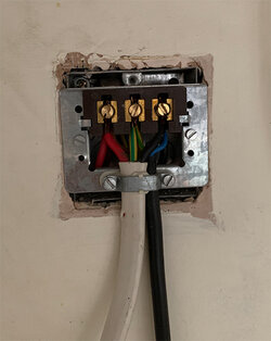

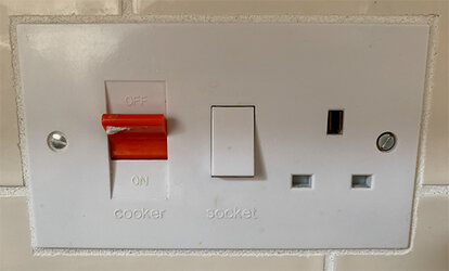

I'd like to buy a replacement oven I can install myself which fits with our current wiring set up. Which is as follows:
32amp cooker circuit
Wall mounted cooker control unit
Hardwired under counter top.
Lots of the single ovens available at Currys have 13A plugs fitted - we don't have a socket below the counter to accommodate these currently. Could I just buy one and cut the plug off? I've read both yes and no in various places online.
Thanks for any help - cheers - Dave.
You should be okay. Looks like you have a 32A supply with 6mm cable?
Diversity applies to cooking appliances, which applying to your hob is about 17A. So adding a rated cooker with a 13A plug (haven't yet applied diversity to that yet), would be max of 30A. The socket outlet in your cooker switch adds 5A.
Let us know what oven you intend to purchase, and we can do some sums.
Applying diversity to each appliance (using 230V supply);
Existing hob = 16.7A (max 7400kW)
New oven 1 = 10.1A (max 2400kW)
New oven 2 = 10.9A (max 2990kW)
Cooker isolator socket 5A.
Therefore highest load is 32.5A, lowest load is 31.8A.
You'll need to verify your cooker supply cable etc (fixed wiring) is 6mm and installation method. If the cooker isolator was replaced with one without the socket, it would remove the 5A, and ensure its below the rating of the 32 MCB. Of course, thats up to you. ;)
If you do get the one with the plug, you'll need to verify with Bosch, that cutting off the plug will not void the warranty; in my experience it does not with most manufactures.
You could use one of these to terminate the two appliance cables;
I would employ an electrician, who verify your cable, my calculations and install the dual outlet plate and test & certify.

the new oven can be wired directly into your existing outlet plate, ensuring that all connections are sound. this mat entail fitting ferrules to the oven flex after you cut the plug. refer to midwets post #5.
Bit confused by the above? Are you saying the cable from the outlet to the oven must be 6mm?
If I buy the one with the plug would I still need to change the cable? Does having a plug on the end mean a different cable is used?

1) Yes, this is the final circuit cable from your consumer unit to cooker isolator/cooker outlet plate.
2) Diversity can be applied to cooking appliances, because either the selection control and or thermostats prevent the maximum load being achieved. Google diversity for cooking appliances, others can explain it better than me.
3) The dual outlet, ensures the different cables are better terminated, ensuring the strains of the wires are contacted by the terminal screw etc. Ferrules will ensure the flexible cable wires are not displaced under the terminal screw as @telectrix said.
The final circuit cable must be suitably sized; typically 6mm cable is used. This needs to be verified, for the load you intend to connect.
The one without the plug top, has a slightly higher load; the manufacturer is erring on the side of caution, as it may too much for plug to handle. The dual outlet plate is a better way of connecting these appliances.
