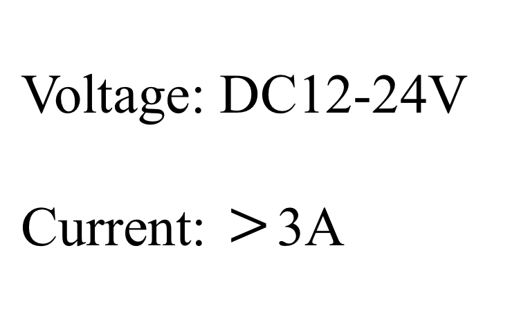

for the amp etc I was was going to Power it with 24v 6amp adapter, this can be reduced to 12v does this help or am I better with 24v
Lead will be pinned to the underside of the deck and into a void at the end of the deck housing the equipment, so that rules out the potential trip hazard,
Depends on what the amp needs.
