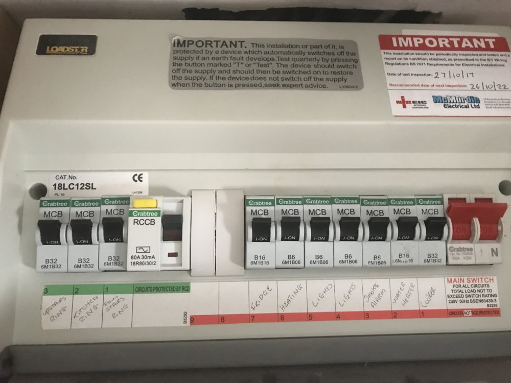

In terms of power you will not be anywhere near the limit for a 13A socket, but for anything outdoors you have to consider both water (and insects, etc) getting in and the effects of UV light on some types of cable causing them to degrade. Also anything that is within touching height outside has the additional safety hazard of faults potentially causing a fatal electric shock due to someone also being conductive to the true ground.
You might already have the 13A circuits protected by an RCD in which case that is OK, but you really need to check.
Recently light circuits would be RCD protected as well, but many older installation are not, so if you have any plans to power this from an existing PIR light cable (which may be very convenient as the cable is already accessible outdoors) you need to check what sort of circuit (and any RCD protection) is used for it.

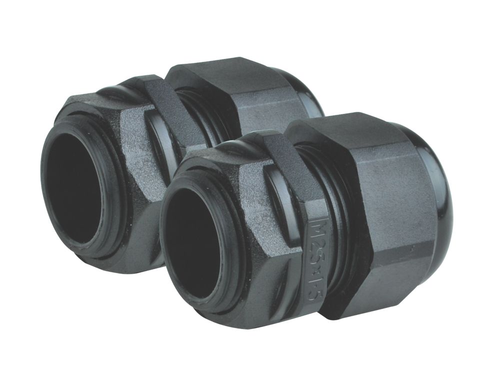

Just make sure you get a suitable gland for the cable to seal it where it enters the external socket box, and better if you can fit on the bottom as any imperfections in the seal are unlikely to let water in. To use it at the 13A capability (in case you ever plan on using it for power tools, lawnmower, etc) you should get something like 3-core 1.5mm cable.

If you don't have RCD protection for your property then you can get RCD adaptors (or even wire-on plugs) which would also be a simple way to make a safe external power outlet.
However, one disadvantage of many RCD adaptors is they have a "no volt" release, so have to be turned on after any power failure. This is deliberate so power tools don't come to life unexpectedly if the supply fails and is restored with the tool still switched on!

Yes, property I fitted with RCD protection

If you do go for a junction box then make sure it is rated at IP65 or higher, and get suitable glands for it. Again, for all of the outdoor stuff try to have cables come in from below, or sides if you must, but not the top as its an easy way for water to get in.

Wago do an IP65 box, but bizarrely it is supplied with IP54 cable bushes:
https://www.NoLinkingToThis/p/wago-abox-lever-connector-222-series-junction-box/9390g
This box is cheaper but you need bushes for any cable:
https://www.NoLinkingToThis/p/ced-ip65-adaptable-box-80-x-80-x-52mm/14556
Here are some bushes that the Q&A says will do 6-12mm and the suggested cable is specified as 9.2-10.7mm so ought to work:
https://www.NoLinkingToThis/p/tower-male-comp-gland-20mm-2-pack/80851
But you can get similar stuff from Toolstation, CEF, etc.
