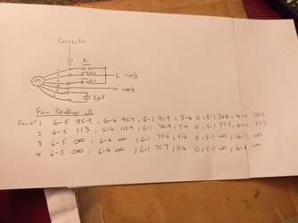

Here is the drawing: I have taken all measurements from the connector. To the right of the connector is PCB stuff, shown to help but these were not in cct when measurements taken.
All other readings between the 6 connections were infinity, that is greater than 1999 ohms on continuity. I have shown infinity readings for comparison with the other motors which had readings between the pins. 20200608_214856.jpg
Hmm. Fan 2 might possibly be operational on one speed only. The others all look pretty much FUBAR to me. 6-1 appears to be the aux winding which has the same resistance on fans 2, 3 & 4 so is probably OK on these. But fans 3 & 4 seem to have open-circuit main windings, as there is no continuity 4-1.
On fan 2, adding the resistances of 6-1 (aux, 74.9Ω) to 4-1 (main, 37.3Ω) gives 112.2Ω, which tallies with the reading 6-4 of 112.9Ω, so provided the main winding doesn't have shorted turns it stands a chance. We can't detect shorted turns here from resistance alone, as unlike the aux winding there are no others to compare it to, and two speed taps are O/C at the leadouts which could hide any shorted turns between the taps. But neither of the resistances of fan 1 match those of fan 2 and they don't add correctly, implying that there are shorts between the two windings. It's a bit odd that the aux winding appears high rather than low, but it's academic really.

You are saying the readings between what we assume are speed taps were infinity yes?
So 1-2, 1-3, and 2-3 all show infinity on all motors, this would imply one of 2 things to me, they are not what you/we think they are or all motors are toast.

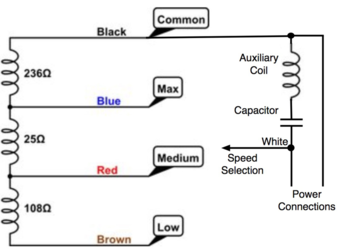

The L would be the L/H power connection and N - R/H but if this is the case then we are either assuming wrong or their is something definitely amiss.
Note this is off google so clearly example resistive values in there.

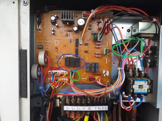

Thx, 20200606_11313.jpg20200606_20235.jpgbehaviour of the a/c units were as follows. A/C unit no1 - Fans 3 & 4, no fan action, system overheated and tripped out, PCB survived. I agree both these fans look dead.
A/C Unit No2 - Fans 1 and 2 appeared to have a delayed reaction as they should start when the compressor kicks in but they kicked in momentarily about 60 seconds late and then blew the PCB and tripped the breaker. Normally with A/C fans, they start slow and only when they cannot contain the temps do they go to high speed, if that still does not keep temps down the compressor drops out and the whole cycle starts again. I could not get my head around no readings from pins 2 and 3 to any other pins. I can check the PCBs to see if any relays have welded contacts.
Top image i have highlighted relays (blue), caps (green) and fan connectors (red)
Bottom image i have highlighted fan connector pins (blue), burnt tracks (black) and power connector (red)

I assume this is what we are assuming it is -View attachment 58713

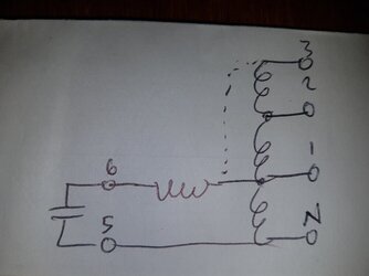

DW Going by the readings on fan 2, I think these motors have the aux winding commoned with tap 1 on the main (which, from the other leads being O/C we might assume is the nearest to N, although I've normally seen it done with the end of the winding as I've shown dotted).
This permutation makes the resistances of fan 2's winding, possibly the only one partly intact, add up correctly. Pic coming...

@Lucien Nunes What doesn't make sense and is common to all motors is the lack of a value between the 'taps' and also the Aux 6 to 2 or 3, in either of our diagrams it does not make sense that these are infinite on all of the fans.
Single phase not been something I deal with too often although I know the basic concepts I am just wondering whether these fans are specialised with some form of centrifugal switching in play which does the usual drop out of the starting cap' but possible also engages the 2 lower speeds to be used on demand.. this would explain the infinite reading on all the taps except full speed as the windings are not in circuit until they centrifugal switch has changed state.
I'm also puzzled by that, but I don't think there's anything as complicated as a centrifugal switch here, as it's clearly made down to a price and ordinary tapped PSC motors do an adequate job for multi-speed fans. The cap value looks typical for PSC run duty. I think the windings are just completely frazzled and perhaps the coil ends are stressed at the leadout joints and blow open when the rest of the winding shorts. Or perhaps the joints have corroded and gone open, even the main section of the main windings on 3 & 4 are open rather than short. I'm seeing this on some coils in cinema organ actions, where even in a perfectly dry environment, after 80 years the enamelled winding wire has corroded right through where there are flux residues near the solder joints.

Also i have looked at the relays and i have continuity across the relay that switches pin1 on the first PCB and on the other PCB i have continuity across the relay that switches pin 2.
Checking the relays R1 for pin 1 is std 5A capacity relay, R2 for Pin2 - they have used the high capacity version of the same relay type (10A) and R3 for Pin3 is a std 5A one again, all NO . So two poorly relays as well as burnt tracks,,,
Relays welded shut are consistent with the evidence so far. As I mentioned in #5, if two relays close at once (or one closes while another is welded) part of the main winding is shorted and the circulating current can exceed the supply current by transformer action. The impedance of the non-shorted section might be high enough not to blow the fuse at first, giving things a chance to overheat.
I've seen in at least one commercial design, and I'd do it that way myself, using changeover relays so that relay 1 applies power to one connection, only when relay 1 is off does it's NC contact pass power to relay 2, and similarly for power to relay 3. That way, barring an internal failure in a relay, it's impossible to cause the sort of "shorted section" fault described.
