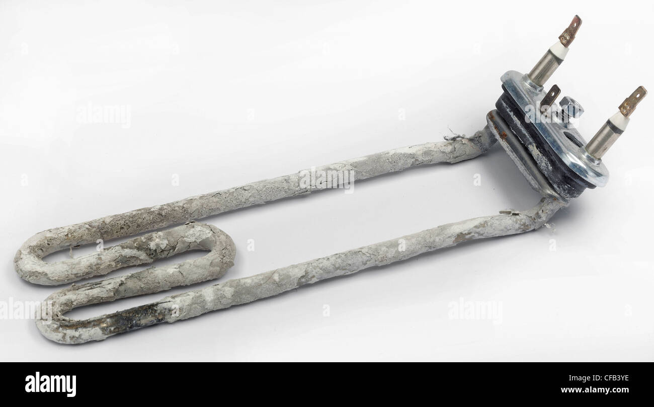

you'll always get some banter on a forum. seriously though, if you think it's not the thermostat, then the element is an obvious suspect. maybe it's furred up with calcium chloride( from "hard" water) and needs a clean or replace.

The element looks in pretty good condition. It's still shiny and blue like it was when I first got it.
I actually use the tank to test different cleaning chemicals and they've helped to keep it in good condition.
I think the advice given has been very helpful, as Tel says the element could be furred up, it's a logical step to replace the heater, advice would be to get a larger Wattage one to avoid over working, it's like having a boiler in your house that's not large enough for the job it would hardly ever switch off and eventually pack up out of exhaustion, hence my suggestion in the previous post, as for the joking around, it's a fun thing there is no malice in it or intended, you will find there are guys who will poo poo someone who is not an Electrician, and can become quite outspoken, most of the guys who have contributed to this post are in no way like that, an example of what I mean is Tel's reply to do an IR test, you may have got a response along the lines "he's a DIYer what does he know about insulation testing" but you didn't you got constructive advice.
