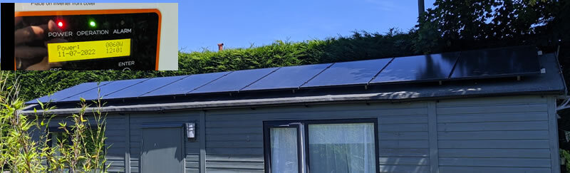

Back in March I had a solar system installed. It was installed on two outbuildings, and as one of the outbuildings has a tree near it which can cause some shading, I was advised to have optimisers fitted to 7 of the 9 panels on the array. The second building (5 panels) has no such shading, so didn't need any. Each outbuilding has its own subboard, and each array has its own inverter wired into the subboard. The generated power then comes back to the main fuseboard where we have a battery inverter and batteries fitted.

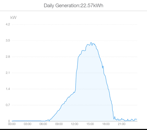

All works well, and we are getting plenty of power generated, but I started noticing an interesting thing on the app's monitor - the power output would build slowly up until around midday, and then suddenly bounce up massively.

...so I looked, and the leap in output coincided with the shadow of the tree coming off the last of the panels.
Here's a photo (actually from a different day, but you get the idea) of the panels with 4 partly shaded, and the inverter showing an output of 60W
Advice on my installed solar system - missing optimisers? panels-with-shadow-output - EletriciansForums.net
...which confused me, as I understood the idea of the inverters is so the panels act as if wired in parallel, so that panels that are not generating are skipped but the other panels can generate.
At the same time of the day, the other unshaded array of 5 panels was putting out 1270W.

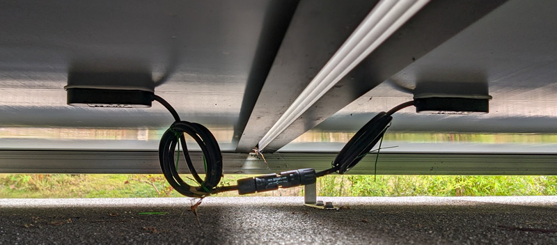

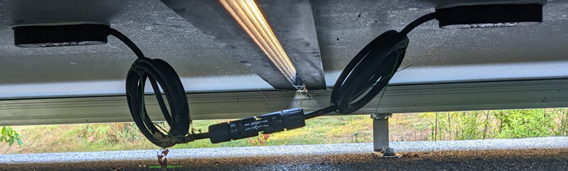

So I went up onto the roof and had a look underneath. Each panel was connected in series, with no evidence of an optimiser being fitted.
Advice on my installed solar system - missing optimisers? sola-panel-connection - EletriciansForums.net
...this means of connection was the same for all 9 panels, and for the other array of 5.

Difficult to say from pic. There does appear to be something there as panels normally just have a plug and socket where yours has a plug and socket but a free hanging oblong box.
To be fair, panels have bypass diodes built in to deal with this but there does need to be a minimum voltage needed. The inverter carries out a periodic Power point tracking calculation and it looks like the jump is the inverter doing a re-calculation and moving to a different volts range to get more power.

Thanks for the reply.
Sorry, the angle of the photo wasn't great - the right hand block that looks a bit like a box is the coiled cable viewed end on...
Advice on my installed solar system - missing optimisers? sola-panel-connection2 - EletriciansForums.net
Solis model is S6-GR1P4K
OK, there is no optimiser on those panels. I will look at the inverter tonight when i get back to see what i would expect to see with your set up.

To be clear, the graph I posted is a combination of the two arrays. When the electrician set things up, he asked if we wanted the monitoring to be per inverter, or summed as one feed, saying that the one feed was what most people chose, so we followed that advice - he did explain that the amount showing as generated would be minus any consumption within the outbuilding. I assume therefore the CT clamp that monitors output was fitted to the main cable supplying power to the outbuildings (and sending it back from the panels).
So where the graph is showing a growing output up to 12ish, that is mostly from the second array - which at the point I took the photos was producing 1270W, with the 9 panel array just giving 60W.

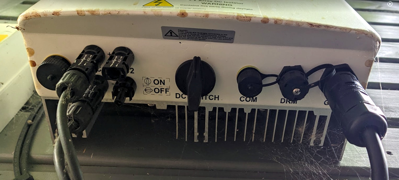

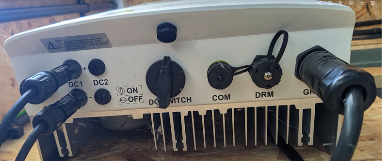

Assuming the other inverter is also Solis, what would be helpful is a photo showing clearly the underside of the inverters, i need to see how many DC cables (black) are connected and to which ports. I need to see the Comms port to see if any wifi or wired comms have been installed. I am totally confused about the Cts and your graph as if your load is showing as a positive in production the graph is just nonsense and i would not rely on it.

Also are both building the same orientation and panel angle, i.e. are they both comparable as if 5 panels can produce 1200W and 9 is only giving 60W at the same time, given the above then investigation is warranted, regardless of a couple of panels having shading.

Both buildings are pretty much identical orientation, and roof angle is the same as well.
9 panel inverter

The other array's inverter is a Solis as well, though a S6-GR1P2.5K-M - sized for the smaller array I assume.
5 panel inverter

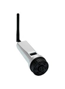

The Solis Inverters offer a cheap simple comms using Wifi devices that plug into the Comms port.

Part No: SOL-DLS-W3
They are around £30 each and you need two, one for each inverter. You do need a wifi signal from your router at the outbuildings or they will not work. If you get these you can download the App, its free and configure them to your situation. That way you will get proper actual production generated and it also outputs each PV string Volts and Current , so a good way for fault finding and getting the optimum out of the array.

The panels you have are quite sophisticated and can handle shade in terms of not killing all production but the inverter is trying to get the best out of all the panels combined and sometimes its better to split.
