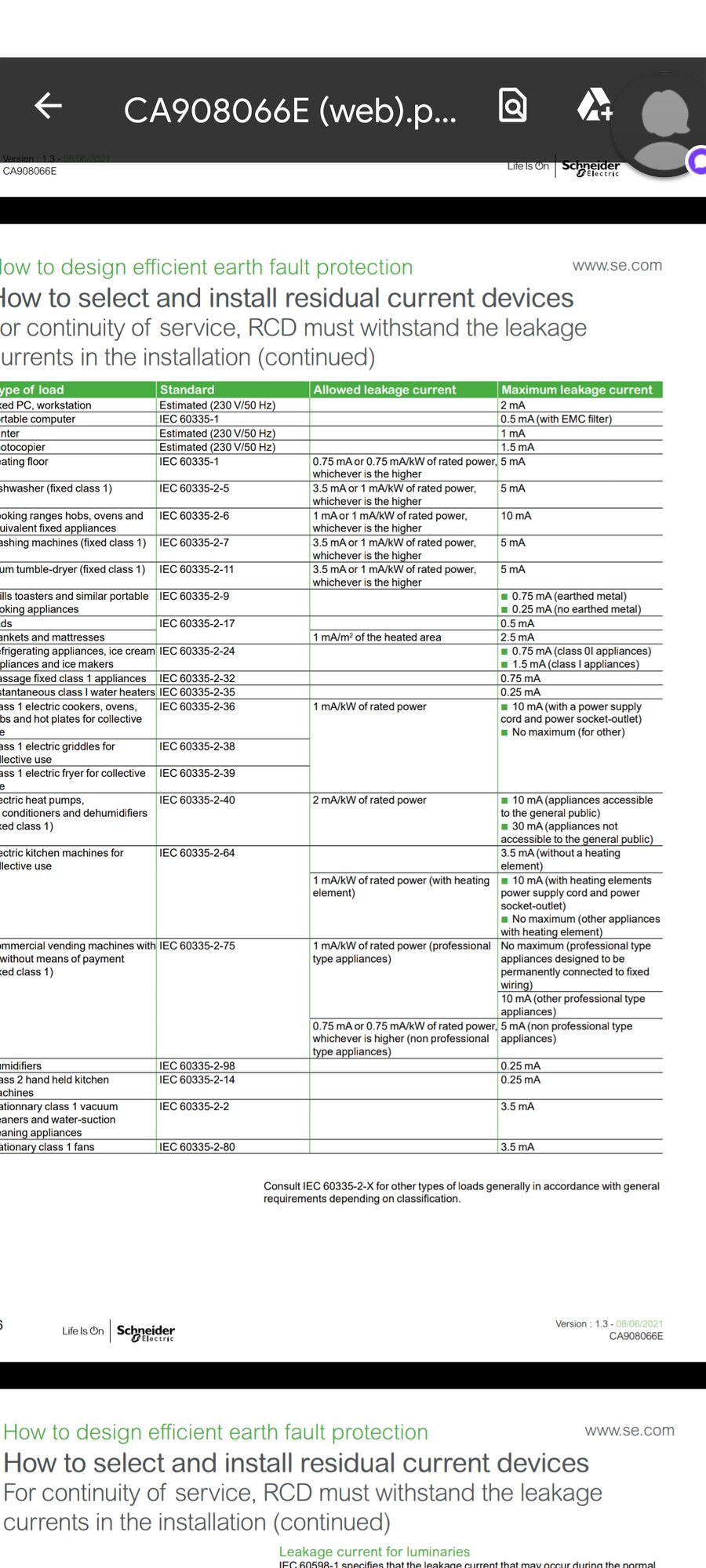

I suspect most modern PC stuff is only about 0.5mA, probably less for class II, so putting 9 double sockets on a 20A circuit is fine. If in trunking you can make it radials but with a looped high-integrity earth easier then full RFC style.

Yes im going to go to site and confirm how much is class 2. Am I right in saying class 2 devices do not leak any current to earth as they are not connected to it?
Correct
