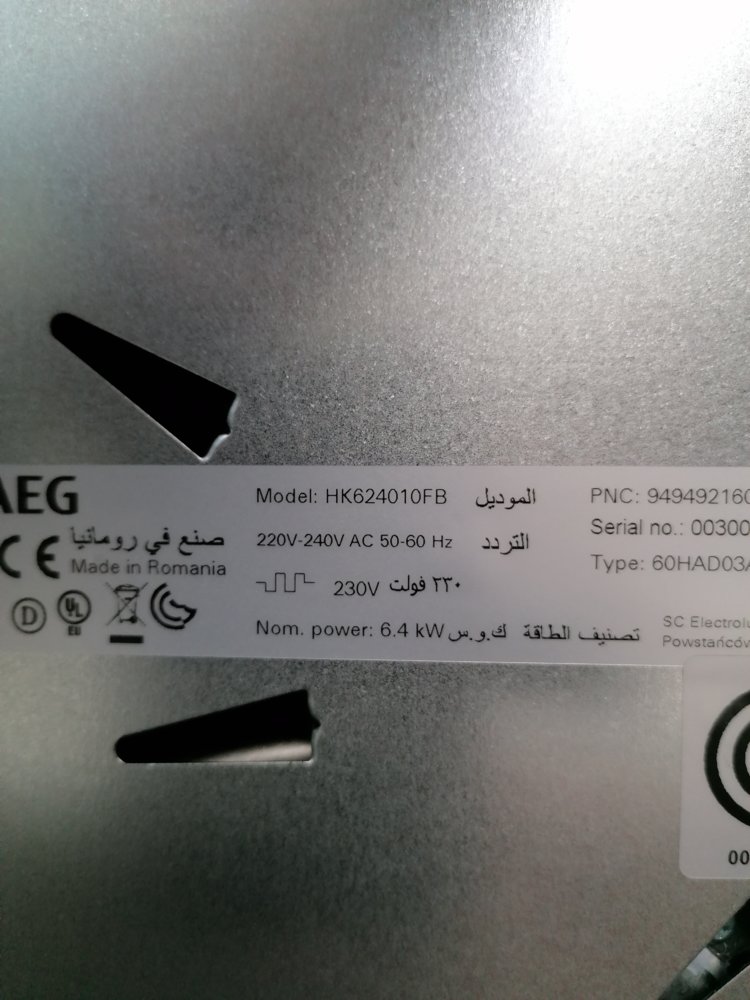

I assume we are talking of the final connection, between the properties fixed wiring and the appliance?
Yes you can use heat resistant flex, but not necessarily just heat resistant. Any suitable sized cable may suffice.
What does the manufacturer instructions say?

Hi it says to use H05BB-F or H03V2V2-F that withstands up to 70 degrees.
Standard PVC twin&earth is rated at 70degs C.
[automerge]1585496237[/automerge]
6.4KW = 27A. That is the absolute max for 2.5mm cable. I’d be looking for 4 or 6mm.
how big is the MCB for the circuit?
If you are talking about a short length from a cooker outlet to the hob then Toolstation sell short lengths of 6mm T&E that avoids a lot of unused wire being bought, for example 3m coil here:
Otherwise if you really want to use round cable then you can buy the HO7RNF style of cable by the meter from CEF or Superlec. I would suggest at least 4mm for a 32A circuit, for example:

OP’s are always told about fixed loads on radial cooker circuits, diversity etc. As been calculated, this hob would have a maximum load of 27A, less with diversity & cycling of each cooking zone.
IMO 2.5mm flexible cable will be fine, OP could probably get away with 1.5mm. He might also have difficulty terminating 6mm cable in the appliances termination box. And before anybody says anything, bootlace ferrules should be used with flexible cables in this scenario.

Hi so am I best using ring crimps like the yellow ones or non insulated ones. The hob has 4 screws in so could take them out and use these if that's safe and allowed.
all depends on the terminals in the appliance. some use ring crimps, some just have the wires inserte alongside the screw ( with ferrukles if flex). have you got a photo of the terminals?

This is what I originally done but thought it wasn't ample enough so came here for advice. I don't know weather to use bootlace ferrules or ring crimp connectors. IMG_20200401_191801.jpgIMG_20200401_191819.jpgIMG_20200401_191750.jpg
you could use ferrules. the terminals have a square trap plate under the screws. for 2.5mm cable use blue ones.for 4mm or 6mm use yellow. however, as the flex is terminated to the side of the screws as opposed to under the screws, as you have it in the pic.is fine. just make sure that they are tight.
