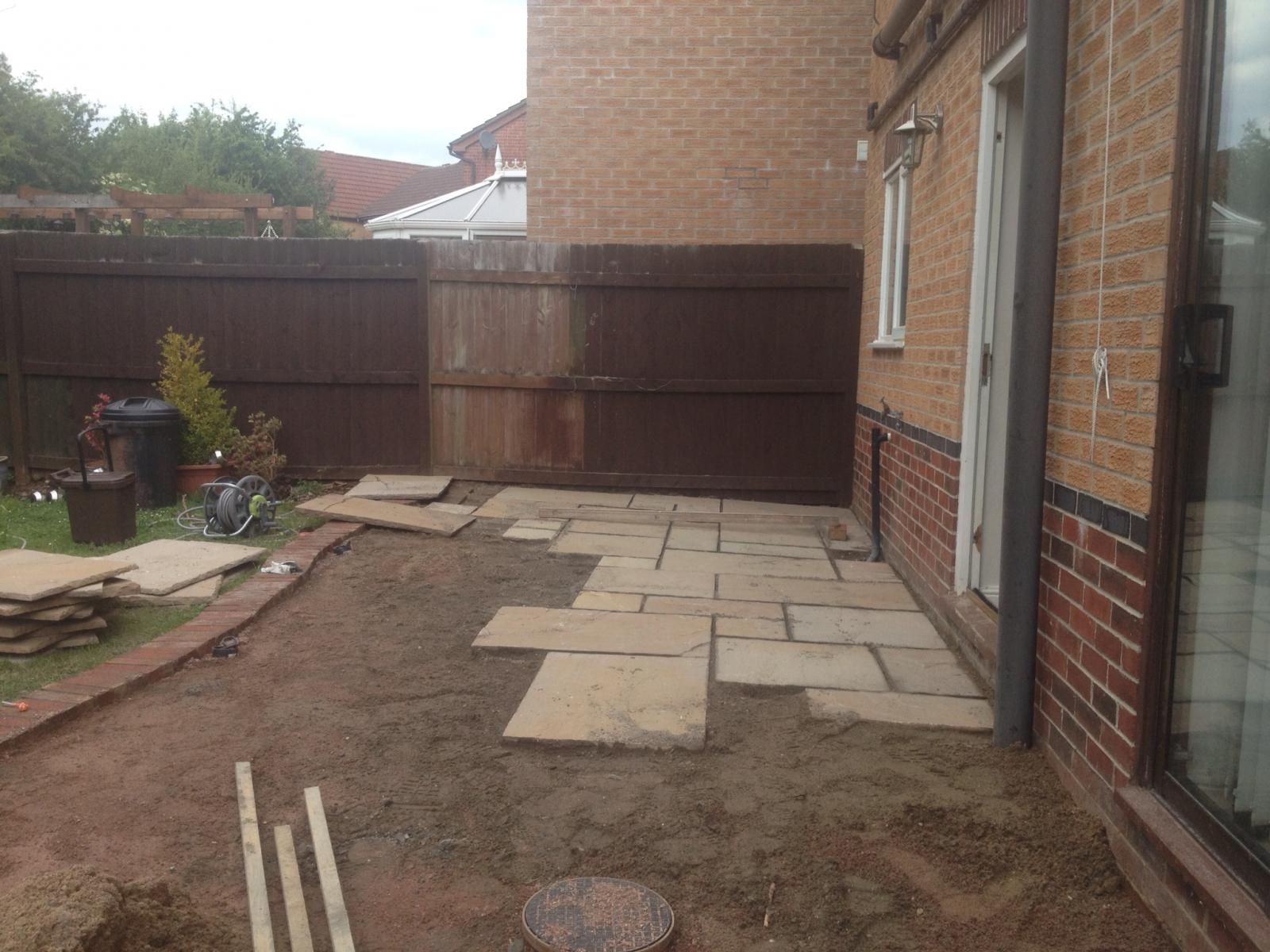

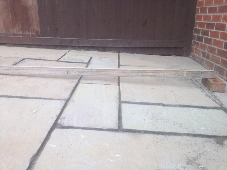

Been away for a week, before I went I arranged a builder from Rated people to lay some slabs in my garden. I was then adding some recessed lighting.
Well I can't wait until he gets here tomorrow, the first part is like a donkeys hind leg, and finishes at the same hight as the DPM whist also falling back into the house.
I will post some pics up later on, what a mess.

The first thing I'd ask you is what did you agree on before getting him to start.
Even if the the new paving was graded away from the house, it'd be above the DPC by quite a bit from the photos. Looks like there should of been a bit of groundwork done before starting.
Is it Indian Sandstone paving? If its getting laid onto a dry sand or sand cement bed, you're running into problems pretty soon anyhow.
If for whatever reason he couldn't slope it away from the house, at very least an ACO drain should have been fitted.

Where is the top of the stone closest to the house? How far down is it from the damp proof course?

Its not, he has brought it level to the DPM.
No need to slope back to the property at all, he's just put the edging in about 200mm to high. It helps if firstly you get your ground work right.

Silly me, I always thought that a path/patio had to be below the DPM!

Anyway he's been told, level base, lay on wet mix ! and finish below the at least 2 bricks below the DMP
Thing was if he had just lifted the existing and laid on the old base he would have been at the right level.

150mm below damp proof is whats recommended in regs i think
As stated above, an ACO linear drain into the surface water drain would be grand. Also saves having all the water run off onto the lawn and water log that
