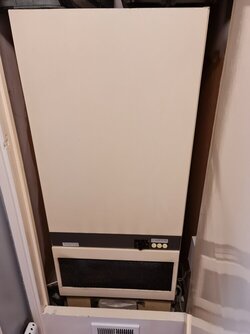

Hi All, after a bit of help and wondered if anyone can tell me if they know the make/model of this storage heater. Recently purchased a property and this storage heater does not work, so looking for parts to fix it or may replace. There is no manufacturers make or serial numbers I can see on the unit. It is fairly distinctive with three push buttons on the right lower side just above the filter (FAN/FAN/BOOST & DAY ENERGY) with a fan speed dial to the left. Also conscious that there could be asbestos within the unit so a bit weary on touching it without knowing.
Any direction would be appreciated.

Thanks I have looked at the back and there is no labels at all. The unit is the size of a stand up fridge freezer and build into a small cupboard. Nothing on it at all. Mystery

Cheers James - Yes there is a heater power switch outside of the cupboard and also a honeywell thermostat. I have chapped a few of the neighbours doors to ask the question but they either don't know or it was replaced years ago by previous owners with something more modern. I have switched it on and tested it overnight however just blowing cold air so know the fan at least works.

Here's a pdf of an earlier or later version than the O.P
Thanks Snowhead think this is a older version of a warm air unit likely 70's - the link here is more modern looking.
There seems to be a few specialists that repair them, I bet they've bought up all the spares that show discontinued on the spares sites.
It's possible the fan and thermostat etc (which do work) are supplied from your main consumer unit, whereas the heating element (which doesn't work!) would have been supplied from an 'Economy seven' supply/consumer unit via a timeswitch. As has been mentioned, is there any sign of a timeswitch, or remains of another 'fusebox' near your consumer unit? I think it's as likely to be not working because the timed supply is disconnected somewhere, rather than there being an actual fault with the element.
