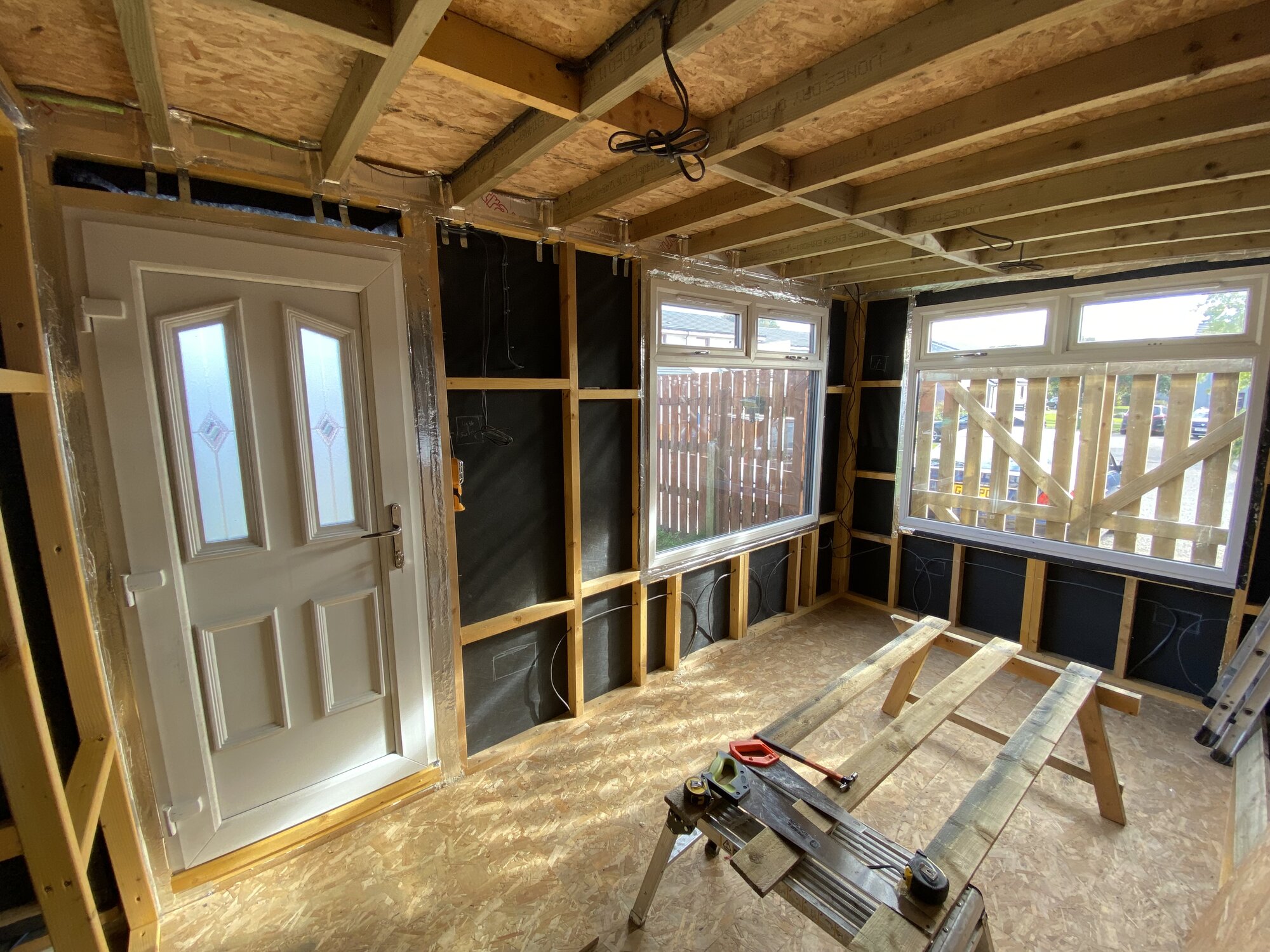

Hi Everyone, I’m new to the forum and joined to gain more knowledge from you guys that are practicing electrical work. I studied 17th edition electrics at college a few years back and passed with great scores but never went on to use my electrical qualification in practice, I used my cabling skills and went into installing full office computer networks and config of the install bespoke to clients needs. My question is - I am currently building a summer house/office at home and have what you guys may think is a random question - I have a 4 bay consumer unit for the summer house 2x6a which will be 1 for internal and 1 for external lights, 1x 32a which will be for the ring main but there is a 16a MCB, having looked around on toolstation and Amazon most consumer units have a 16a MCB, I’m just wondering what I would use the 16a for? I am actually thinking of switching it out for another 32a MCB and creating a separate ring main circuit for a few outside double sockets to keep them on separate trips? Happy for any feedback that is constructive (I have seen plenty of forums where the response is - if you don’t know find an electrician) Thankyou in advance :c)

Thanks for the advice, I wanted to pre wire everything first but leave all wires visible for an electrician to confirm everything is good before plasterboarding and then final inspection after the sockets and lights are in place. The feed cable is 16mm 3 core armoured cable, length is between 12m/15m and is rated for direct burial from Doncaster cables. Feed out from house is a 63a trip, My thought process was just a simple 32a ring for summerhouse sockets 32a separate ring for the shed end of the building, same for the lighting 2x separate 6a for 3 internal and 5 external lights.

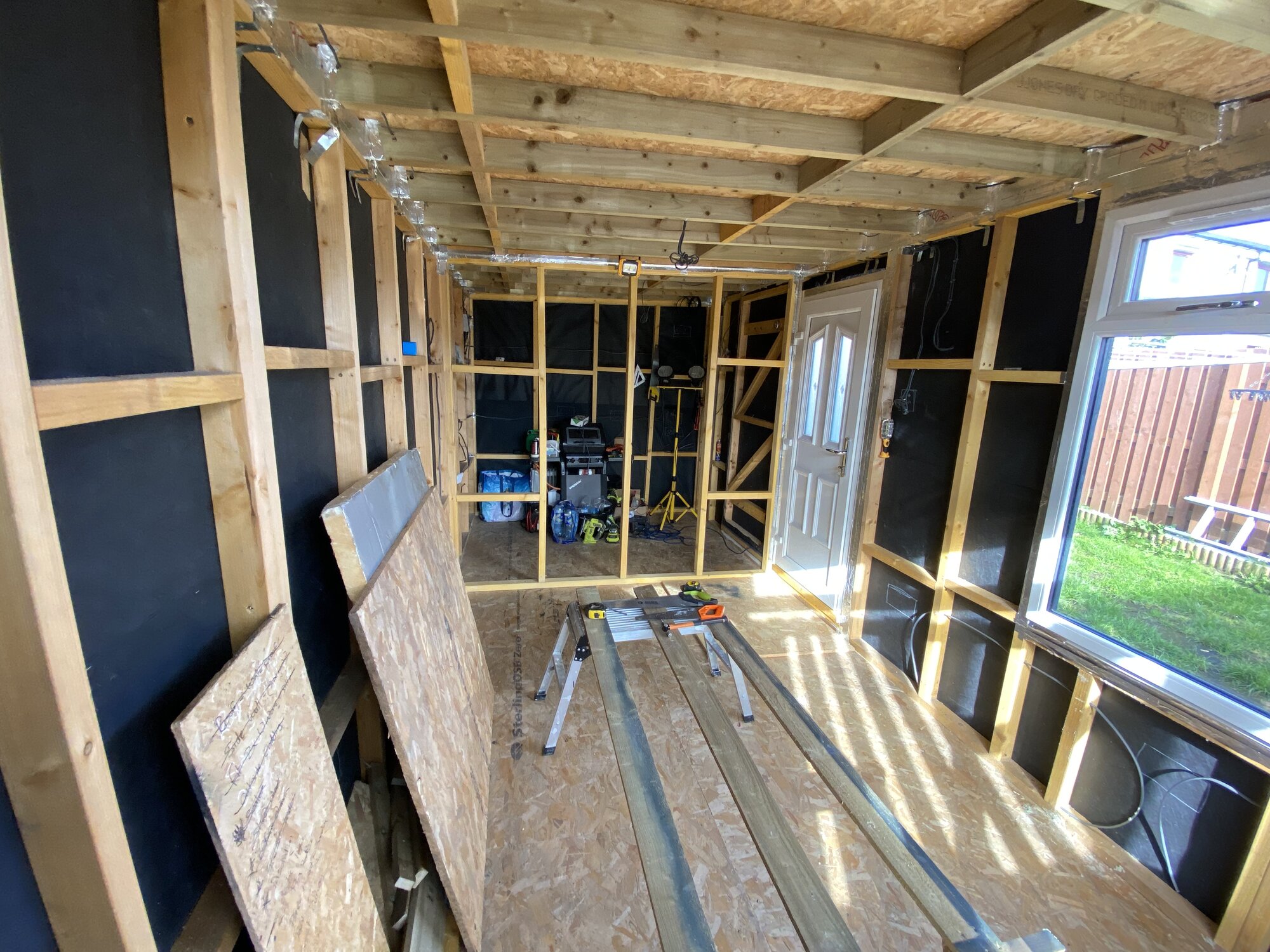

Thankyou for taking time to respond, you are 100% right for the electrician to come out and see what is in place, and then correct my thinking, you are also correct that I have tried to stay within what I know and probably better ways of doing this. My building is just a water tight shell and only the 2.5mm ring wires for plugs and 1.5mm for the lights, the wiring is all visible and can be amended as required without any hassle, I agree a ring is over kill at the moment but I was trying to future proof it’s use as I don’t know what it could be used for in years to come, at the moment it will be a couple of computers with dual monitors, a projector and possibly a small oil heater / panel heater depending on how cold it is over winter. I spent last winter working from a touring caravan in the same build spot but now for something more permanent.
Just for FYI on my story the armoured cable is only connected to the office/shed consumer unit, the other end is still on the roll by the house and will only be connected once an electrician is involved.
The attached pictures were taken as I was feeding wires not completed before it’s pointed out it’s radial in the pics :c)

• the sockets in the summer house should be happy on a 20A radial in a 2.5/1.5 70° PVC twin
• lighting on a 6A radial in a 1.0/1.0 70° PVC twin
If you want to put your outside socket/s on the 16A then that'll be fine...

If it was me installing the summerhouse I’d be taking the 32amp breakers and swapping them for two 20amp and I’d be running two radial circuits instead one internal and one for the exterior socket if your only installing one external socket use the 16amp
I would throughly recommend you rethink what your putting into the consumer unit to comply with RCD protection I’d be installing individual RCBO’s in a board with a main switch and not an RCD incomer
Lastly you will be supplying the summer house with an 6mm armoured cable don’t take the earth from the house into the summerhouse terminate it outside the building or use a compression gland on the consumer unit end and install an earth rod connected to the consumer unit earth bar
