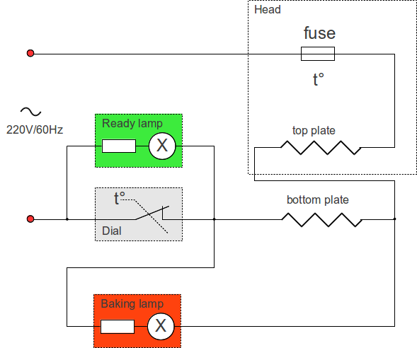

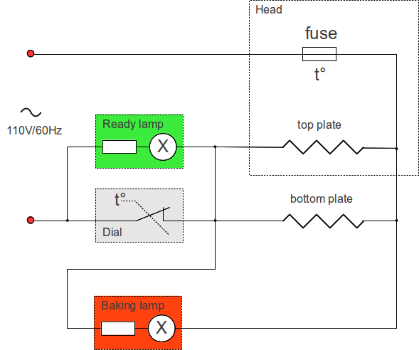

Ok, inside was a pretty simple circuit but with really messy wiring.
Original Schematics (110V):
Corresponding wiring was:
First of all it's easy to see that we really can connect plates in series without any danger to change their operation mode:
Moreover, it's possible to reuse existing wires:
And this works very fine! Cooking timings are as specified in manual for standard 110V mode.
Each waffle-making session lasts at least 1 hour, and no problems were detected during 1 year of exploitation (about 20-25 hours of heating).
May be this will help someone else who will buy this model from US =)
