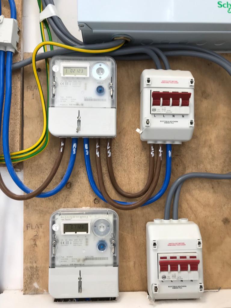

I have just completed an EICR on a new (2017) conversion and noticed the E7 looked unusual.
Is this the norm now to connect E7 to the main board feed from the meter?
There is only 1 appliance in the flat requiring E7 and that's the tank with 2x immersion heaters. Both are connected to the same supply at the board.
Surely the main electrical supply doesn't now switch off overnight and E7 take over?
I've attached a pic but would appreciate your opinions.

It's a dual rate meter and powers up L5 when off peak is available.
The devices requiring off peak electricity can be fed from a second CU (or space in the main CU, if big enough), fed from L5, or from the main board, using their own time switch.
It looks like the second option has been taken here. Disadvantage is that it requires the DNO off peak switching and the local timeswitch to be kept synchronised if full price operation of what should only be using off peak is to be avoided.
both meters are connected in the same way.
yes, I'd run a second supply from the meter to the E7 accessories but I've not seen both L4 & L5 joined together at the isolator before.
yes been inside isolator. I expected 1x L to be live and 1x L to be not. Both were live and assumed they were unexpectedly joined together to use the 1x L feed to the board and 'time share' its use. The client was sold the flat on the basis of it having an E7 connection.
So, I'm wrong about the isolator and the L's should be separated, then that means the E7 was on, perhaps permanently and not connected to anything.

You need to check whether the meter says R1 or R2 at different times of the day.
L5 should only be live when R2 is displayed. L4 should be live all of the time.
Ideally, there should be a link between the two neutrals at the bottom of the isolator.
The installation gets full price and off peak electricity at the appropriate times of day (hopefully), depending on whether the display shows R1 or R2, but the installer chose to use a local timeswitch for the water heating, rather than the DNO switch.

The client told me the property had E7. After testing it looked like L4 & L5 were connected together, despite the separation at the isolator, because L5 was live during testing. As there is no onward connection from L5 I assumed (Wrongly) that some form of sharing was taking place with the onward L4 as I'd not seen an allegedly active E7 configuration like this before.
Client is not happy to be told there is no E7 connection to her flat :(.

The definitive answer will be found on their electricity bill. If it shows R1 and R2 and they have different rates per kWhr, then they have E something, if not E7.
How did you test L5 was live?

L4 is normal rate, L5 is off peak. It may be like this so that a second board for heaters would come from L5, but in this instance, it’s linked to L4 on customer side, meaning the whole house will run on L5 during off peak hours.
The will connect the tails like this to all dual rate meters make them all the same, just for ease.

How are they joined? L4 feeds the board and L5 is unused, or am I missing something?
Am I misreading this but there is nowt connected from L5 at that four pole isolator.
How is L4 linked to L5 on the customer side exactly?
Unless the meter has been programmed to act as a 4 wire meter where all output is metered at rate 2 in the Off peak period, then part of the useage will be charged at rate 2 but part will still be charged at rate 1 in the Off Peak period with L4 / L5 linked, depending on how the load splits over the 2 meter outputs.
The Off peak set up is very much standard and correct from the energy supply, using an integral meter for off peak switching, 5 terminal wired through the correct off peak isolator, which has no load connected to it. If you look at the top NN , that is to give two N connections the bottom part is linked across, L L in picture L off peak (not used) L 24hr supply.
They have used their own time clock in the CU to switch over presumably to fall inline with the meter off peak times as the whole 24hr supply goes over to off peak too, it could be E10 that gets an afternoon boost also early evening too.
However full off peak switching has been provided by the energy suppler, its there if needed .
Economy 7 or 10 is a tariff, and depends entirely on a dual rate meter being fitted. Nothing that comes after the meter is anything to do with the tariff as such, just how you choose to use it.

The meter shown in the pic. is a dual tariff meter, which should display R1 or R2,depending on the time of day, and this should be shown on the customer's electricity bill.

I've read through twice and didn't know E was so complicated. Essentially then, this installation could have some form of E linked through the meter/isolator and run whole property using L4 as there is no separated E feed from the isolator on L5.
The electricity on L4 is charged at full rate (R1) for 17 hours a day, and at the cheaper rate (R2) for the remaining 7 hours. L4 is permanently live.
L5 is only live for the 7 hour period, and only at the R2 rate. During that 7 hour period you can use the electricity on L4 or L5. It's exactly the same electricity and exactly the same price.
