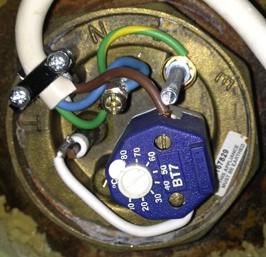

Over the past few days my hot water tank hasnt been heating up the way it should and in the morning we have no hot water.
Im in a flat with no gas so i have an electric immersion tank with two heaters (Overnight and boost)
i know that the thermostats are normally the problem and after listening to the tank at night when it ticks over it sounds like there is hissing coming from the heater but not as much as there normally is and not as much the the boost heater.
So today i was going to swap round the thermostats and see how it went tonight. On taking the covers off on both of the heater it seems like the wire positions on the thermostat are different. They are both the same thermo (Backer BT7) there are two wire locations one for the brown wire and another for a white wire that attaches to the heater. On the two i have they are both wired differently, they have both worked for the last two years.
So my question is doesnt matter where each of the two wires are connected to the thermostat???
Cant find anywhere online that will tell me?

Are you saying one of the elements is still operational and the other has failed, or both? Before I changed the stats over I would be first checking the element to see if that is at fault. Is the MCB still in or has it tripped? Do you have the means to check the element?

The job seems simple enough i took a picture of both of the thermostates then proceeded to take them both out. When i tried to fit the lower one into the bottom i saw that on each picture the wiring was different. So i put it all back and thought i would do some research.
One thing i did see that was very odd - As i said the thermostates were both exactly the same (backer BT7- with same labels) appart from the point that slides into the tank(heater). One was like a spear or a golf tee and the other seemed to have been flattered at the end on two sides making it an X shape. This X shapes seemed to hinder the thermostate from sliding into the lower over night space.

just different age of stats bate the bottom one has probably been replaced before as it gets used more. It sounds more like your element could be going TBH but your doing the right thing checking the stats first. Do you have a multimeter

Be careful here. Some stats have the safety cutout built-in and some require a separate unit. I realise that it seems a simple job, but you really should get a local qualified electrician in to sort this for you. If you live in a hard water area then it could even be an element scaled up and operating poorly. The only way to know for sure is with proper diagnostics. A good electrician will also test your earth loop impedance at the element to ensure the system is all connected properly, along with the RCD protection if you have any.
I agree with the others. Usually - water boiling, thermostat - water cold, heater element.
As Somerset says, safe isolate, disconnect the wires from the element, test the resistance of the element with your multimeter. Don't test with the wires in place.

Hi, I have been away a lot recently so I have not had a chance to do anything with the water heater. But just before I went away my new thermostat got delivered. It is slighty different to the one I have in place already but probably only because the temperatures are not printed on the top. So my question again is really... does it matter on this one where I put the wires into it. I have notice on the top that there are plus and minus signs but im guess that is just for temperature and not +/- to do with the wire placement. Sorry to be a pain but I just just want to cause myself more problems. Let me know what you think. Thanks
new el.jpgHere is the picture of the new thermostat
Here is a picture of the old one in place

Just put a piture of the old stat in place on the tank - dont know if there is a cut out ....!?
The reason behind the new safety cutout is that people have died due to tanks boiling over and venting back into the plastic header tank, which subsequently melts and dumps gallons of scalding water on those below.
