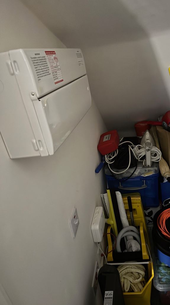

This is a cupboard under the stairs of a domestic property, there is a consumer unit and a BT modem which is plugged in.
Outside the cupboard in the main living room is a combined optical smoke and heat detector, is it worth adding an optical smoke detector in the cupboard under the stairs to protect against the risk of a consumer unit fire / bt modem fire?

If it makes you feel safer, then by all means. Its your house.
Depending on the current make of detectors in your home, it may be easy to use a 10 year battery detector, with radio link to the others... or it could be standalone. It doesnt, by regulations, need to be linked... but obviously it would be an earlier warning if they all go off together.
Unlikely the modem would spontaneously burst into flames, and you have a modern metallic consumer unit...
Any problem may arise from what looks like a 45A switch. Is that for a cooker or shower through the wall.

It’s a 50A isolator switch on its own 32A breaker that feeds the 13A front socket which has its own RCBO built in that can be used for car charging, only use it when required for plugging the vacuum in as don’t have an EV, they were all fitted as standard when the houses were built.
New build?
I wonder if anyone here with more knowledge than I could say whether the underside of a staircase is boarded in flame retardant boarding?
I know its an issue with consumer unit under stairs in old properties with just the bare underside of the stairs showing.
Looks like Aico detectors.... according to the sticker on the unit. Can easily be added to with the radiolink detectors and a radio module fitted in one of the others. Which will most likely be mains powered, wired interlink.

Yes, I very much doubt something as sensible as that has been done, the door of the cupboard is standard and not fire rated, no insumescnent seal.

I'm thinking to just add a battery radiolink detector under the stairs and pair it to an RF module which I'll add to one of the hardwired ones to link em all.
Wasn't aware Aico did a combined smoke and heat! I know they do a combined Co and Heat though.
The consumer unit (BG?) looks to be compliant with latest regs regarding IP rating for fire resistance, so risk there is really minimal, and doesn't required fireproofing under the stairs.

Yeah it's a newer BG Fortress CU, it's been professionally checked and the wiring is quite neat for a new build, all tight.
