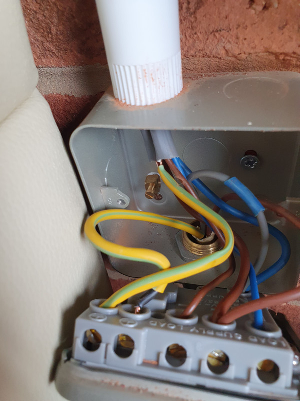

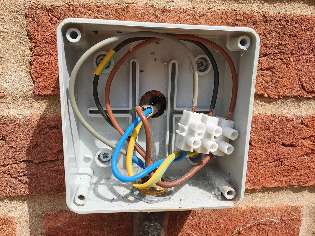

So, I started to do this today and have hit a stumbling block already. I had assumed that with the house being only 2 years old, that everything would be done properly and up to code. However, upon opening the junction box outside, I found that there is no connection from the swa armour/nut to the CPC. That surely is not correct? I thought that the armour must be linked by a bango/piranha nut etc to the rest of the cpc (at least that is what I was taught during my level 2 unless I have misunderstood something)
Here is a picture.
I am therefore assuming that to do this properly, I will need to get a piranha nut, some crimps and a bit of green and yellow cable so I can link the armour properly (I assumed that would all already be there for me to just link it all up in the earth terminal on the socket!)?
yous correctin that the steel armour needs to be earthedusing a fly lead ( i would fit a bit of 6.0mm).also, looking at that connector block, there's enough exposed copper conductor to short a bus out.sure you can rectify that. personally I'd use wagos.

Any particular reason why the fly lead csa would have to be so large? The csa of the line conductors to the supply of the junction box is 2.5mm, and then the swa from that is 1.5mm.
I was going to use 2.5mm for the fly.

I'm surprised that something like that would have got passed initial verification on something only two years old. I thought that was a pretty big requirement for swa that goes out and underground (ie for the armour to have continuity back to the MET).
you're right. it's just that i always have 6mm Gn/Y on the van but not always 2.5.
SWA is only required to have the armour connected at one end (if the armour is not being used as a CPC), as already mentioned, so it may well comply.
However, I always connect the armour at both ends and at every joint, where applicable, just to be sure. I believe most sparks would do the same.

If it is going to be earthed at one end I would always say it must be the supply end, lower Zs on the armour and less risk of something stupid being done at the load/accessory end.
Like the above example! If the armour is earthed, it is fortuitous by means of the back box and not by any acceptable connection.

I think what your 1st home exercise has shown is a Golden Rule you should apply on jobs - test and inspect first before you make any changes.
It might well be the installation broken/unsafe to begin with, and that is a whole extra set of donkey balls to suck when you go to test your own work and find something amiss.

Yeh, it is a bit poor isnt it. I thought my criticism may have been unjustified as i thought both ends had to be connected to the cpc. However, then i check the termination at the other end and A. it isnt connected there either and B. the metal back box isnt connected either.
