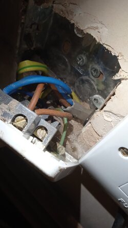

Hi, quick posting - welcome any advice as new to this stuff...
Have a Howden HJA 0150 gas grill/oven with a broken thermostat that and can't get a replacement (grill igniting but no gas coming out of oven burners when on).
The Howden grill/oven is on a ring in the kitchen which has following appliances on it:
-microwave
-fridge freezer
-kettle
-toaster
-a Howden gas hob
-the busted Howden grill/oven
-couple of kitchen sockets generally not used
It all goes back to a RCD with a fuse that says - MTN132 b32 hanger fuse
There is an electrical wall connection for the grill/oven, with (I think) a 6mm wire for the ring (and not the thicker 10mm wires used for showers).
I may want to replace with just an electrical gill/oven. So some questions...
-Is there is max kilowatt oven that I could just wire into the current wall socket (which is used for the current grill/oven electrical ignition connection)?
-Would I need to replace the fuse in the RCD for the main? And is so with what?
-Would these things ensure the fuse would not trip if the oven was switched on?
-There are lots of electrical ovens but the instructions say they should be wired directly to the fuse box, so wondering if there is one which can just run from this ring main (if I upgrade the fuse)?
Would hate to buy an electrical oven and then its a nightmare and expense to fit it (the fuse box is currently full).
Welcome advice.
(attached pic of gas connection, and wall sockets for hob and grill/oven)

It would be adviseable to get a local spark in to assess the wiring, considering you are changing to electric oven then calculatation of a load is required.just to add it may need it's own circuit.

6mm cable is not used for ring circuits. 'One down from 10mm' - are you measuring the outer diameter maybe? This is not how cable size is determined.

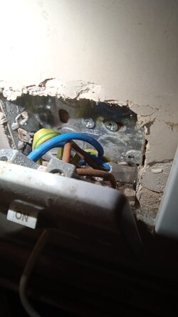

Picture of the fuse box wiring attached for the grill/oven. Assume its the standard burial type for house wiring.
Gas oven replacement easy like for like - but welcome knowing if its poss to get suitable electrical oven with suitable fuse in the RCD considering what's on the circuit?

basically , if your new electric oven comes with a fitted plug, you can plug it into the ring. if not it will need a dedicated 32A circuit.for whick you need to get an electician.

You won't be wasting their time if you pay whatever is agreed between you and him/her to come out and take a look.

I assume its a case of stripping plug so its fit it into the FCU.
See above. Don't cut the plug off (cue debate about invalidating warranty, not). Plug it in.
I would need someone to cap off and cert the gas supply I guess?
Yes. And preferably someone to fit a good quality 13A socket in place of the FCU.
