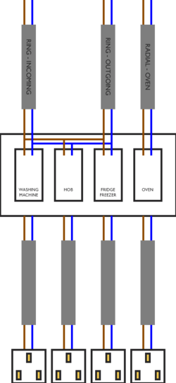

I’m thinking it would be:
Incoming supply to the grid switch (from ring main) feeds an unswitched socket from the ‘outgoing’ load on the grid switch. The fuse would be in the plug top on the appliance.
To continue the ring, this is looped in and out at the grid switches.
See Image (forgive the artwork)

I would be careful with that amount of load running through one area of the ring. Grids are notorious for tight cables, give yourself a deeper backbox if you can.
Your drawing is wrong, as it’s not a ring.
I would put the oven on its own radial, but mounted in the same grid, the ring looped through the other 3 switches.
Think of it as spurs coming from the ring from different positions, you don’t need to fuse down at each switch.
separate circuit to the grid switches, either a ring in 2.5mmor a radial in 4mm. (either way on a 32A MCB/RCBO). switches should be 20A D/P.

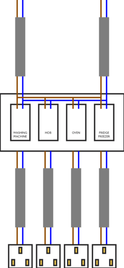

I realised after I posted, I’d not drawn the outgoing leg of the ring.

Thanks for the insight RE the back box and for the tip on the oven.
Am I correct in that I'd wire up everything as per my (new) picture for implementing the grid switches into a ring with incoming and outgoing legs looping between the supply side of the switches?
Where you say that the oven should ideally be run off its own radial. I'm guessing I'd run it through the 'oven' switch on the grid as I would with any ordinary cooker switch? As it's only 2kW, could this not be run off a 20A RCBO with 2.5mm T&E?

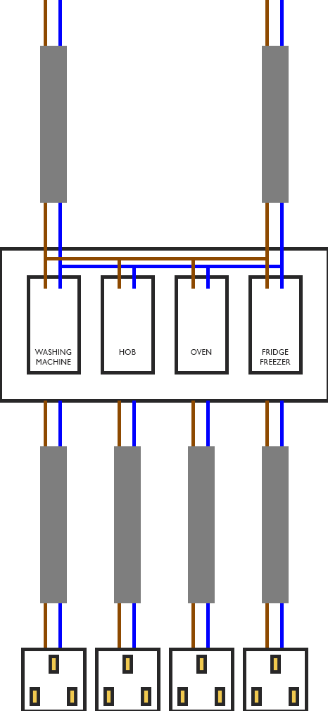

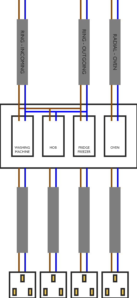

I've added two images that I've drawn this morning, if someone could clarify if this is the correct way to wire the switches as a ring (looping in and out of the switches and treating the loads as spurs) and the second image which omits the oven from the ring and has this as its own radial.

The grid can be part of the same ring as the kitchen, but be aware of high power items that could overload the circuit if all on at the same time.
The oven is the highest draw that I can see. Put it on its own radial.
Any 'fixed' appliance 2kW or over (in this example, the oven), should have its own dedicated supply from the CU.
Igniter and fridge/freezer are trivial loads, and wash/mac. is a high, but very intermittent load, so these three could come off of the existing RFC. They will need fusing downstream from the switches.
In most cases the grid switches will be feeding an unswitched 13A socket, or maybe a FCU, so you have your <= 13A fuse there.

They’ve said that the grid switches can form part of a ring protected by a 32A MCB/RCBO and that the grid switches do not need to be fused providing the appliance that is connected has its own fuse. Moreover, they have said that the 13A grid switches would be suitable fo everything, but did mention a deep back box and perhaps a radial for any high demand appliances.
