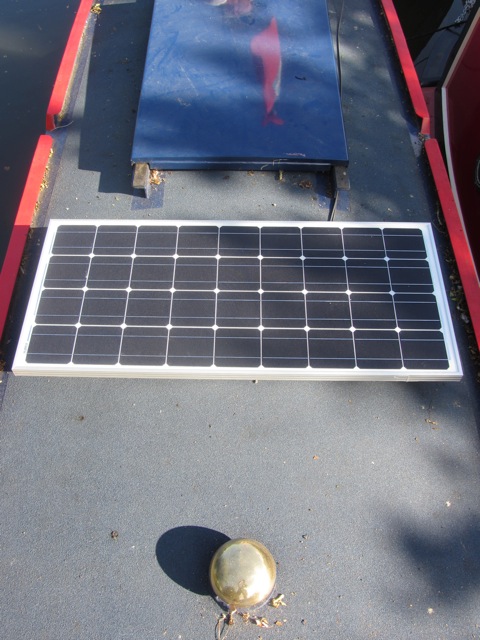

I appreciate the suggestions but am disappointed with the response here. I came here looking for sources of one-off qty panels, particularly higher efficiency panels, either 100W or 200W (although I am now considering larger Wp panels, as with the Hosun I found subsequent to my first post). So no upper limits, except width and length.
I clarified by giving the dimensions of the space: 1m x 5.9m (but narrower than 1m would be best). I can fit 2m length between mushrooms, but am considering various mounting methods (discussing in another forum) including above the mushrooms. I haven't asked for help with mounting here, but it is indeed something I've not finalised so input on this is helpful.

actually tbf it's pretty straightforward as he's running a basic 12V offgrid system using battery storage, so the panels aren't much relevance to the inverter. He'll need a decent MPPT charge control unit designed to work well with the voltage and ampage range of the panels though.
To be honest, it's a long time since I did any battery work, back then I know we would aim to get the voltage point of the panels around the right voltage to be able to charge the batteries with or without a controller, to make the system as robust as possible - ie it'd work anyway if the charge controller broke as long as you paid attention and controlled it manually. This seems to have gone out of fashion, presumably as the MPPT controllers have improved, and I can see the argument when high efficiency panels are only available at higher voltages, but erm yeah it weren't like that when I were a lad and all this was fields.
