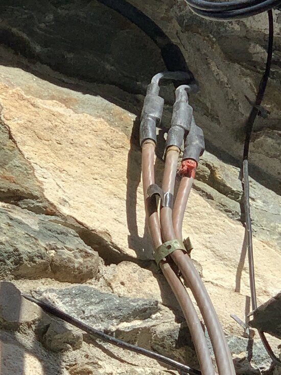

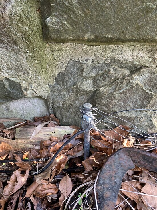

All cabling is pvc T&E, I’ve done continuity, IR, and all well within regs. As for earthing system.......well, the cottage is literally in the middle of nowhere, 2 miles from nearest road, I’m fed from a small transformer on a pole approx’ 60 meters from the house, an overhead cable comes to the table and is then split into 3, 25mm2 cables that run down the wall and into the house so I would say it’s TN-C-S?, however, in the MET there is another earth cable going out to an earth rod??!
If I remove the main earth from the pole and do a Ze, I’m getting 0.3 ohms, so I’m confused by the earth rod.

Possible that it was originally TT, then DNO converted it to PME. You would have to ask to be sure, but your Ze would suggest it is.
There is another possibility sometimes encountered on remote, end of line transformers serving one property, PNB. A phone call to your DNO sounds as if it is in order.
