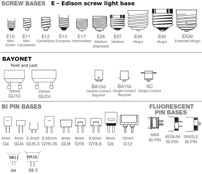

What type of lamp is fitted?

Led gu10s are currently fitted...so if a trannie stops working they have to go through this whole process of finding correct trannie?
If the lamps fitted are GU10 base then they should not be running off drivers, they should be connected direct to 230V, therefore I think something is missing here.

Thanks a ton for the background info. They are MR11 LEDs. Looks like ill have to order them online then what a pitty. I never knew LEDS where this complex to be honest. Where would it say which rating of Ma is required . On the bulb it self? Packaging? For example if it was a new install and you were fitting them.
